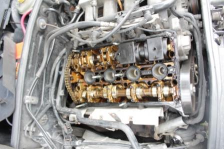

And it would appear that my oil pressure is good- light comes on before I start and goes off when it's running. Also looked like everything was wet with oil when I took the valve cover off

The problem isn't misfires now. I believe they were a result of something else. I've cleared the codes (random misfires, cylinder 1,2,4 misfire) and it runs and idles fine now, other than the loud tapping noise. ICM is new less than 12 months ago and one coil pack is new (#1 cylinder). My problem is mechanical, just trying to narrow down what mechanical part is causing the noise. With good compression I think I've eliminated a bent valve. I just don't know much more about the design of this head. After removing the valve cover (or cam cover as it may be) I see no rocker arms or springs like I would in an older conventional head design.
What are some typical mechanical failures of the 1.8T engine that would cause this loud tapping sound, but appear to run fine otherwise? From my experience I feel certain that it's in the head somewhere. In my mind I picture a failed spring, assuming that's what holds the valve closed- as it would in a non-overhead cam design.
