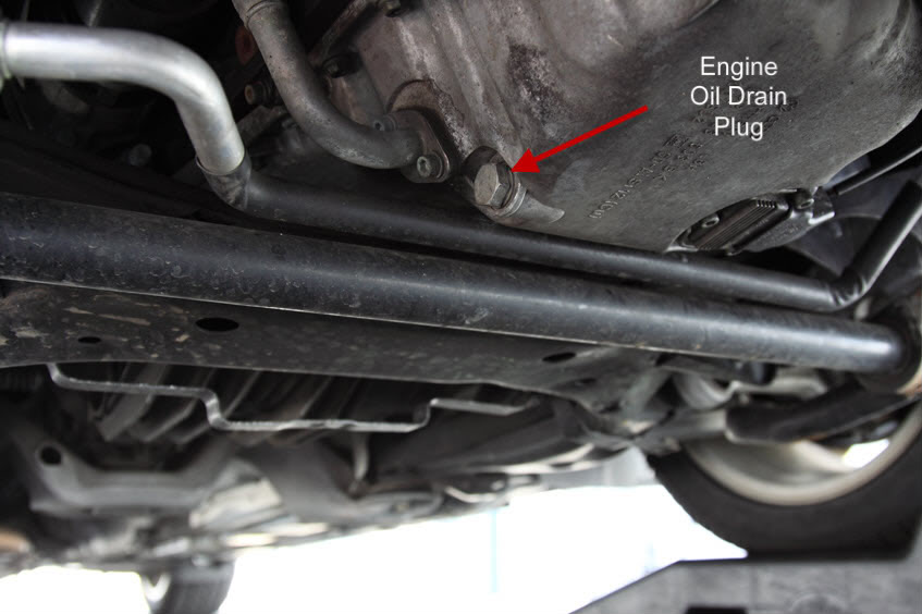

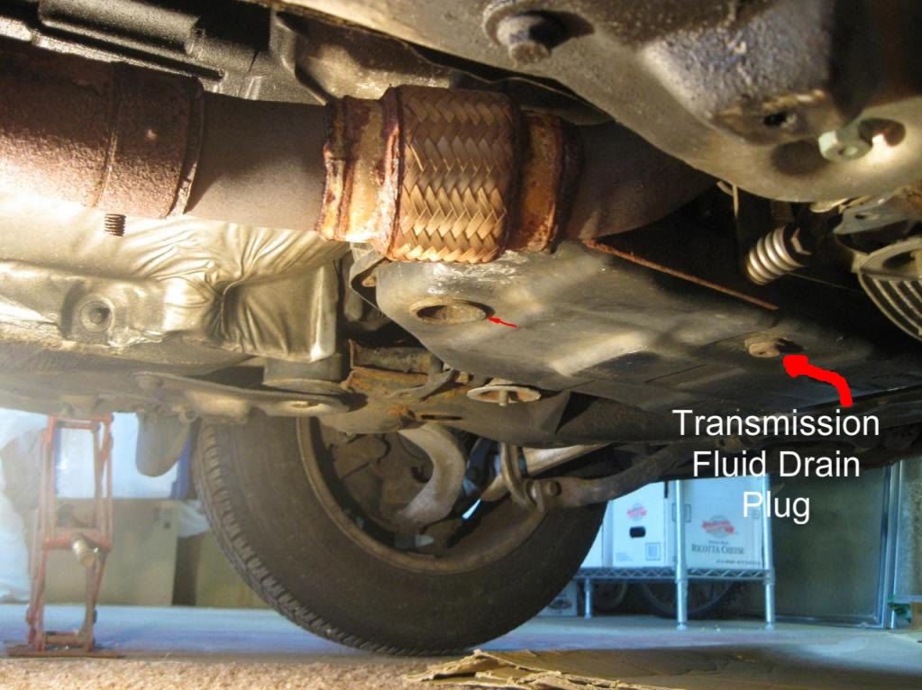

For the benefit of anyone who might find this thread using the search function (if such a person even exists), I'm going to post these two pictures:
Carry on.
