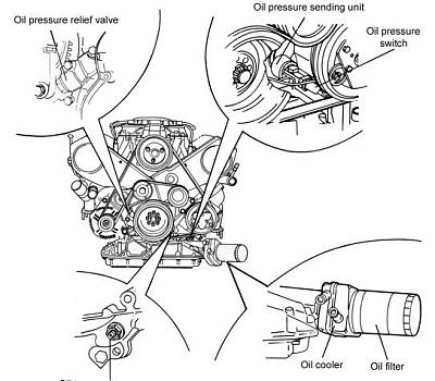

hello!
98 audi a4 2.8L here...
I am trying to replace my oil pressure switch. I read somewhere online that its RIGHT before oil cooler. Once I take it out, than it will be right there. I took off the oil cooler and I dont see oil pressure switch. LOL Could someone PLEASE help me out, I have to put my car together in less than 20 hours.
thank you in advance

It should be above the oil cooler..I spent 10 minutes looking through my Bentley to try and find a diagram for the 2.8 oil cooler but it was not to be found. This is the diagram from the 1.8 FWIW. The oil pressure switch is #10.

Here's a pic for the 12V 2.8, should be ALMOST identical to the 30V....

thanks guys! you were both right. in 1.8 and 2.8 its in the same spot. right after the cooler. This noob right here thought it be somewhere inside where the cooler screwed on.. plus it didnt help that the part was black and disguised :P
