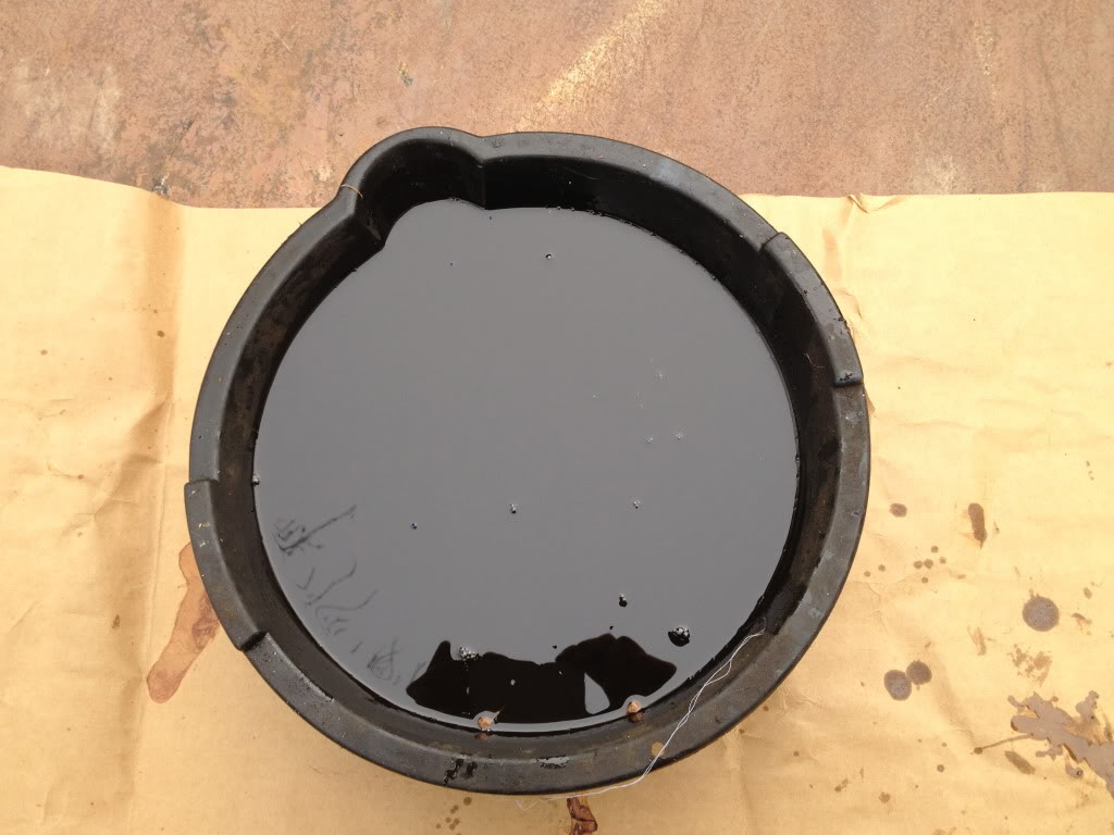

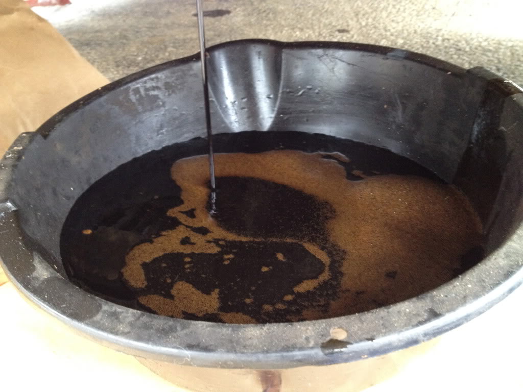

potential head gasket?
just seeing if i need to add **** to my list of things to do
I did my oil change today and this is when it was draining out of the pan
and this is after it sat for 5 min
bad headgakset or just bubbles.?

Could be a ruptured diaphragm inside the oil cooler too - it's been known to happen and cause oil and coolant to mix, making people think it's a bad head gasket. Any running problems or other symptoms that indicate the HG failed?

none at all - thats why i don't suspect a head gasket. but even the oil coming out of the cooler looked fine. oil temp is fine also. what could be some more clues?

Could it have been overfilled? Think I remember reading that too much oil can cause it to do something like that, might not have been for this car though. Also, was the engine warm when the drain plug was opened?
