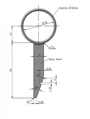

I found all kinds of threads regarding the wiring harness needed for these radios, but none about removing them. Do I really need the special tools? The right side of mine is already free but the left side won't release.

Hello,
you need a blade like in attach.(you can make a blade from a expired credit card.)
Below the buttons, the unit have 2 slots.
Insert the blades in the slots and pull the unit out.
http://www.fitaudio.com/?View=entry&EntryID=78
Cheers
