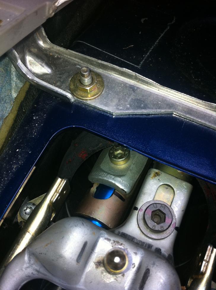

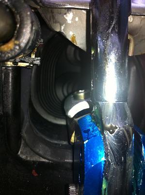

So I finally pulled things apart and Took a look. First it seems there is no reverse lockout for this one. A snap ring had slid upon the lever, making it feel like there was a reverse lockout.
I have no idea why but since i did this it seems to go into second a bit more willingly(though it will still grind of not careful), but first won't go unless you really shove it, or put it in first at a complete stop. This sucks!
Here's where it is nowt sure where to adjust it/ what not

If you've got the push down reverse lock, you wouldn't be able to get it into reverse without pushing down. A good way to check is to take the shifter apart and look for the reverse lockout pin. No pin=no lockout. Sounds like the synchros *might* be on their way out, but this seems more like a poorly installed shifter to me.
