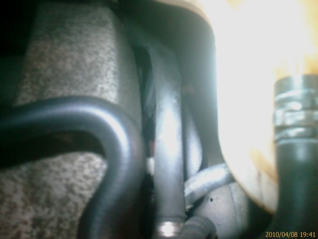

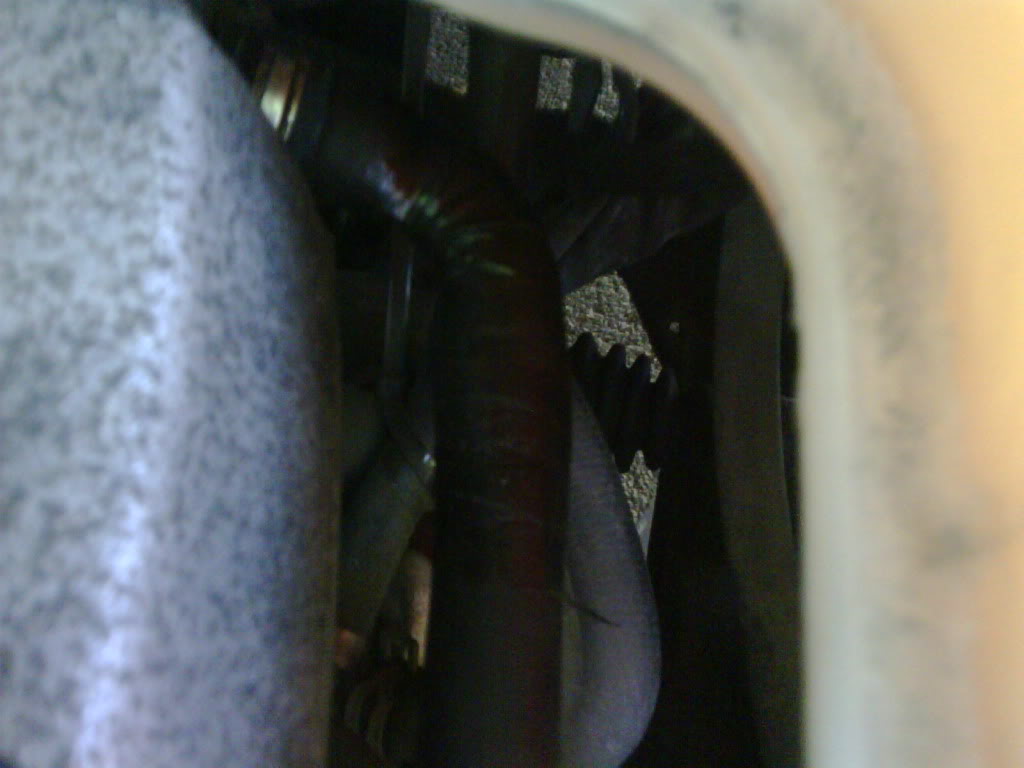

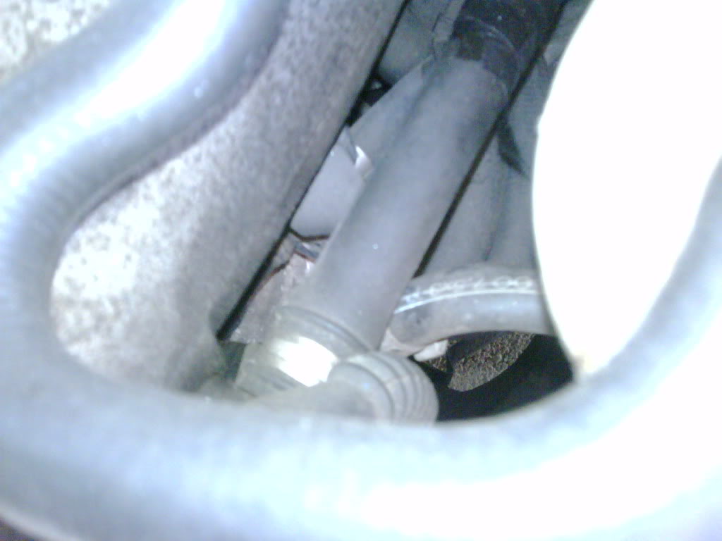

Also issue #2: I'm keep getting the same CEL (forgot the #, but i knwo the description is something like system too lean) and i know after searching when I had the trouble code # most of the results included vacuum leak as a possible culprit. I have this specific hose that has a 1" crack on it: (hope you can see it, its the "L" shaped one right near under the intake mani that had electrical tape running around it, my little quick fix )

Where can I get this specific hose? will this hose work:

Thats the hose. And if you have a leak in it, the cel will go on, and say you are running lean when it becomes a boost leak.
I had the one right above that go and had the same problem. I was too lazy to buy a new one so I used jb weld and duct tape. But don't follow my example and get that hose. Shouldn't take that long to put it on.
