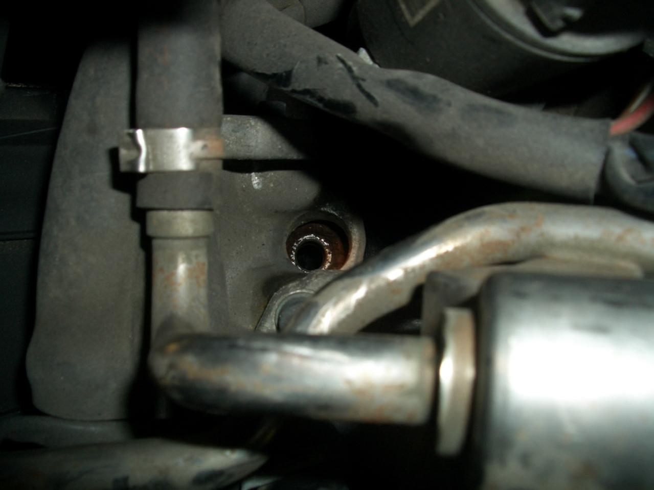

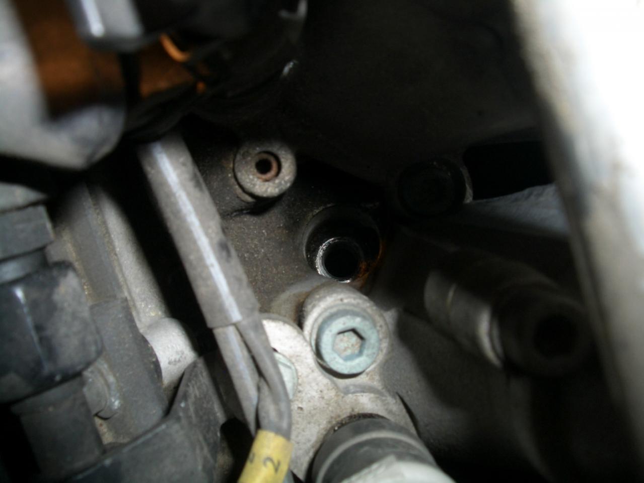

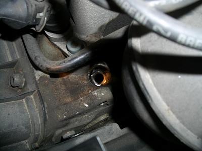

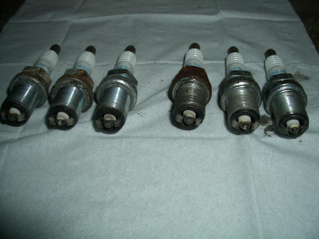

Hi, I decided to change my plugs today (not first time). I started examining each plug and found that at least 4 were really dirty on the top.
There was some rust on two of them and a oil grain mix on the others. I tried everything to clean it up, before I unscrewed the plugs. I actually built a straw onto vacuum cleaner, in order to suck the surrounding area clean (worked pretty good
But as I was unscrewing some of the plugs, I'm pretty sure some dirt fell into the chamber. At plug #6, I can actually see some rust particles down there. They fell down while I was unscrewing.
I haven't screwed in the new ones, because I wanted to get some input. What should I do from here? Is it a concern? Is the oil filter going to catch this? Is it going to get there at all?

i would try to get as much of that dirt out with your vaccuum straw as you can. when i do my plugs i always blow the plug holes out with some shop air before removing them for this reason. if its a few pieces of sand it might just get sucked out of the exhaust ports after a few seconds, or it could sit in there and scratch the hell out of the cylinder walls, its really hard to say. it definately wont get into the oil unless it gouges a path past the piston rings.

Thanks, I cleaned as good as possible and put the new plugs on no probs but I doubt that I would be able to "feel" the dirt anyway... just freaked out for a moment and I was annoyed by the Audi's engine design.

and that dirt could be really old oil or old anti sieze. yea if u got an air compressor, try to blow it out
