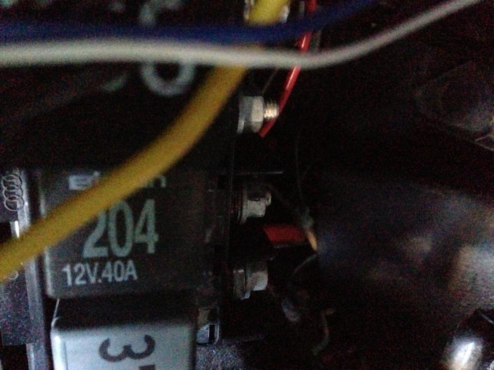

Old Jun 11, 2013 | 10:37 PM
Pbcrazy's Avatar
Joined: Jul 2012
Posts: 988
From: Warrenton VA
What wire/fuse did you tap into for the timer?
Old Jun 11, 2013 | 10:55 PM
HulkB5's Avatar
Joined: Jun 2010
Posts: 429
From: Renton,Washington
It's attached to that middle nut
Attached Thumbnails Stereo not receiving power until turbo timer starts-image.jpg
