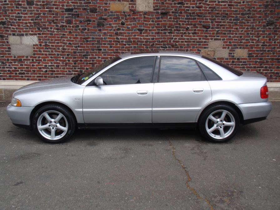

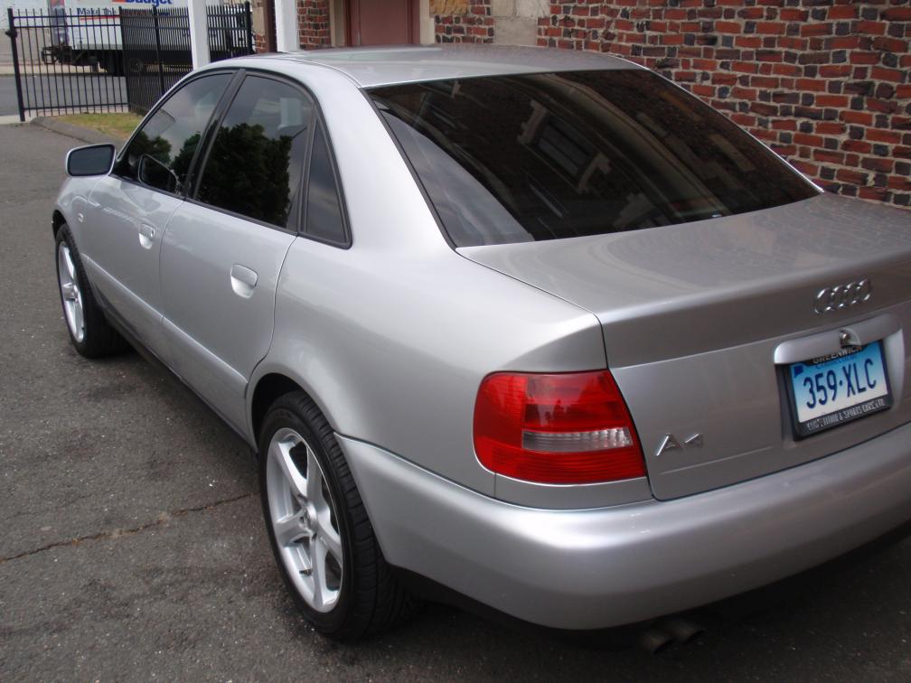

Here is a few pics of her below,as she was,when she was working
