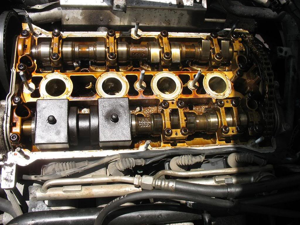

Extraction!
Cams look good which is a sign of good oil pressure! Cam chain is tight, no slack... Hardly any sign of sludge on top.

I also got a sneak peak at the timing belt. It looks brand new to the naked eye, no cracks or frays. That doesn't tell me anything about the tensioner though...

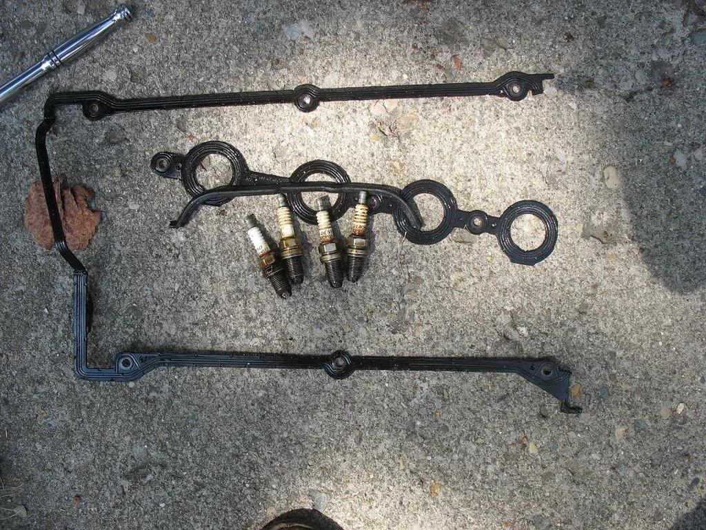

That gasket was gone. Looks like its in good shape on the inside also. Ecs' valve cover kit i think is $35 so that is a good deal.
