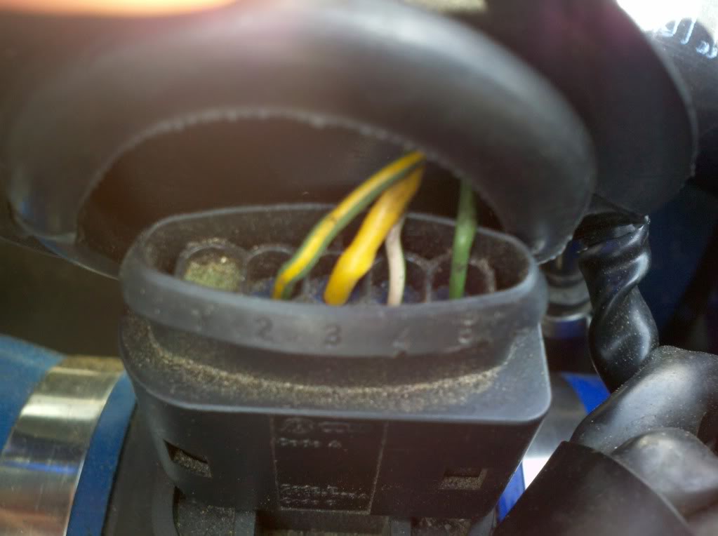

ive took some pictures, but now reading your post mines not a d shape connector, by all means heres what ive got.

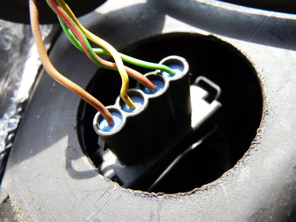

I've got an AWM as well, I can take some pictures after work today if you'd like.

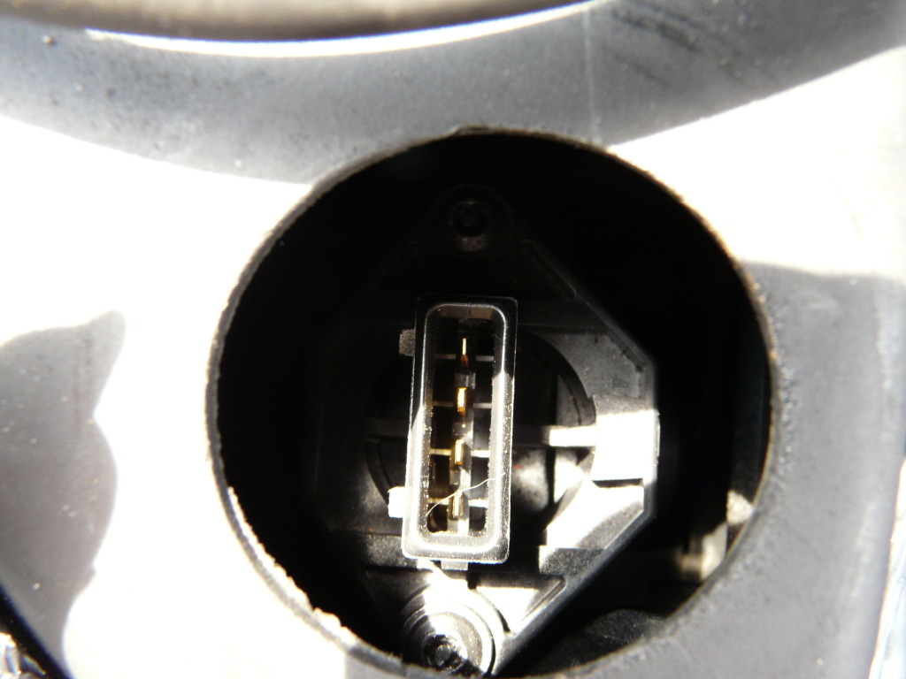

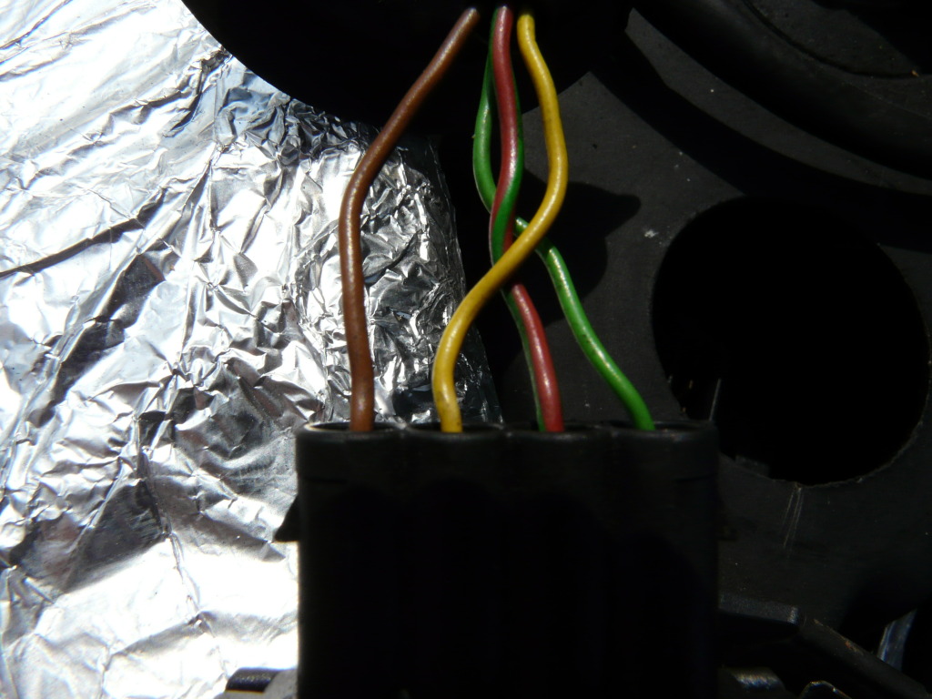

Here ya go:
The flat side of the connector is to the right, looks like from left-to-right the pin out is
1-empty,2-green/yellow,3-yellow,4-white/green,5-green
