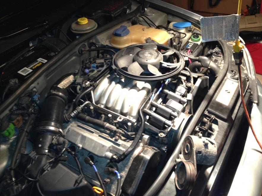

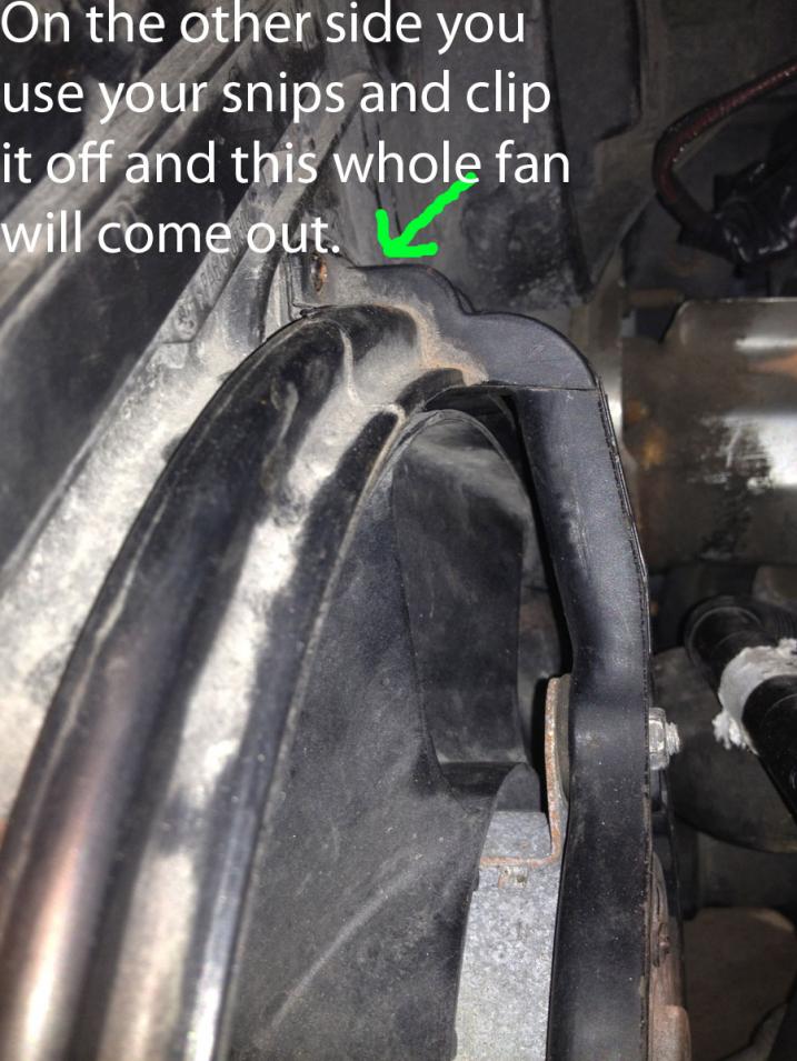

There's not a lot of space in there to access the serpentine tensioner pulley, but one trick is to remove the electric radiator fan. To remove the fan, you have to break off a plastic tab and undo one screw. For the life of me I couldn't figure out how to get that fan out until I read about breaking off the tab.
Removing the fan gives you an extra 2"-3" of space to get at the tensioner. Once you get the belt off, you'll be able to spin the pulley and determine if the bearings are shot. I think you'll want to keep tension on the pulley.

So I replaced the tensioner pulley.. First off THANK YOU redmond1501!! I was trying to remove that fan then i remembered you mentioned something about breaking, I would have never figured that out!
Here are some pictures where you break the clip off and with the new pulley in.

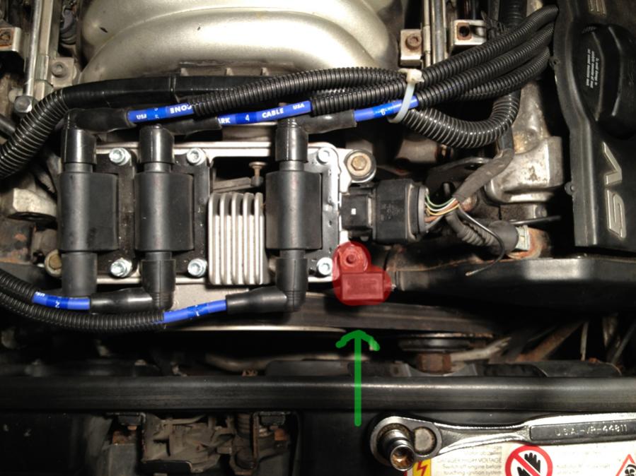

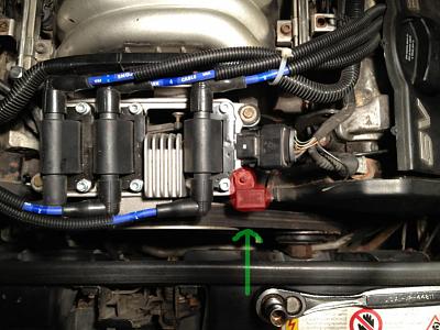

Also in the 1 picture I highlighted a small black box in red thats on the ignition module. Mine is damaged and i had to solder it back on. What is this parts purpose?
