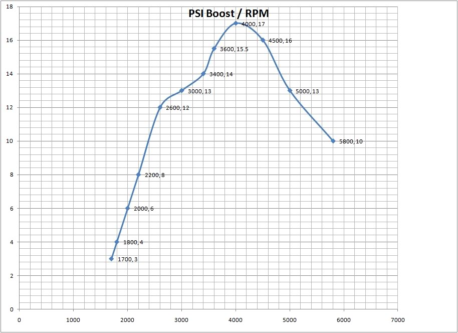

Are you certain about the dimensions on that turbine rotor? Those specs are for a normal K03. I would expect -- at minimum -- a 46/42 wheel from the K04-015.

Pretty sure. Keep in mind its using a K03 housing.
Here is the boost curve (again: with a 'no info what's in there' "TAP Stage 2 chip":

That boost curve makes sense given the restrictions of your K03 turbine rotor. The software has to pull back boost to protect against exhaust manifold backpressure and over-hot EGTs. What does VAG-COM show your MAF to be reading? 170-ish?
