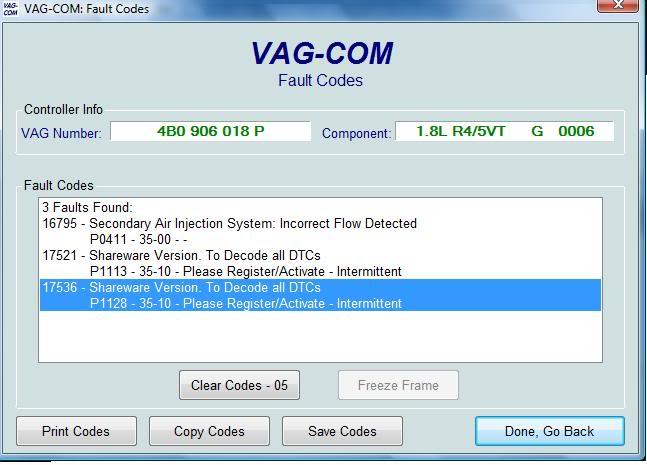

here are the results. any insight?

leak in your secondary air system causing it to run lean and mess up the reading on your o2 sensor. most likely gona be the crankcase breather hose or combi valve. if there are no leaks then your pump could be bad. if you hear a noise like a vacuum cleaner on a cold start, its the pump
