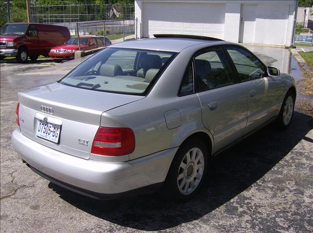

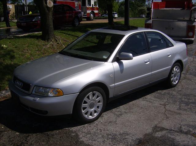

I just got my A4 about a month ago, and I love it! But it came with some pretty rough front and rear bumpers. Before I bouthg it the rear was involved in a light collision and some of the paint has spiderwebbed and there is very light body damage. The front has a 3-4" gouge in it that was touched up with paint, but it is.... well ugly.
My local body shop wants $1000 to pull the front and rear bumpers and refinish them.
But I've been reading on the forums and see that some people are putting on the S4 front bumper, and I think it looks worlds better! But can I also get an S4 rear bumper to fit with no problems? I have a 2000 1.8t quattro, and I am looking to buy this rear bumper http://cgi.ebay.com/ebaymotors/00-01...Q5fAccessorieshttp://cgi.ebay.com/ebaymotors/00-01...Q5fAccessories
The bonus is that this is already the same color as my car.... and I know it might not be a match and I'd have to repsray anyway. Will this fit no problems? And if so I will get an S4 front... the only remaining problem would be that my A4 lowers are not color matched. Suggestions?

The front and rear bumpers are a direct replacement. That rear will color match your car too. The pre-99.5 model year A4 silver is bluer than yours (it's paint code is LY7M and you and the S4 have LY7W silver). Your grilles and foglights will not work on the S4 front end - you need S4-specific parts for that. As for the sides, find a set of S4 sideskirts, or paint your lower trim yourself - my sig pic shows my DIY lower paint (I did all the way around). It's not terribly difficult if you can't find the S4 side skirts.
Reply
Jun 4, 2011 | 09:16 AM
S4 bumper is a direct bolt on to the base A4. You'll need new lower grills and fog lights to fit in the S4 bumper, but all the other hardware is reuseable. Good luck!
