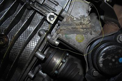

I believe this is called a transmission mount bracket. It is on the passenger's side (2000 A4 2.8L Quattro). There is a mirror (I think) of this part on the driver's side. I'm trying to source a replacement part. What is this actually called? Anybody have the part number? Thanks for the help.

Check your tranny number but this is what I could find
12 8D0399108R
support for transmission
right / DWR,DWQ,DTT, EEP,ENP
(12) 8D0399108AN
right / DSY,DQT,FRQ, FTF,EHW,FTK
8D0399108AC
right / DWM,DWN
I had this break on mine as well. Caused the CV joint on the drive shaft to start to click. Took me(and a mechanic) forever to figure out the issue. I only paid $35 for the part IIRC. Definitely try to get one from a junkyard or call up APspecialties.
*don't quote me on the part numbers being correct - these where taken from vagcat.com

I believe the only part that normally wears out here is the transmission mount, which is part #9. Damaging the steel bracket there would require physical damage really..
