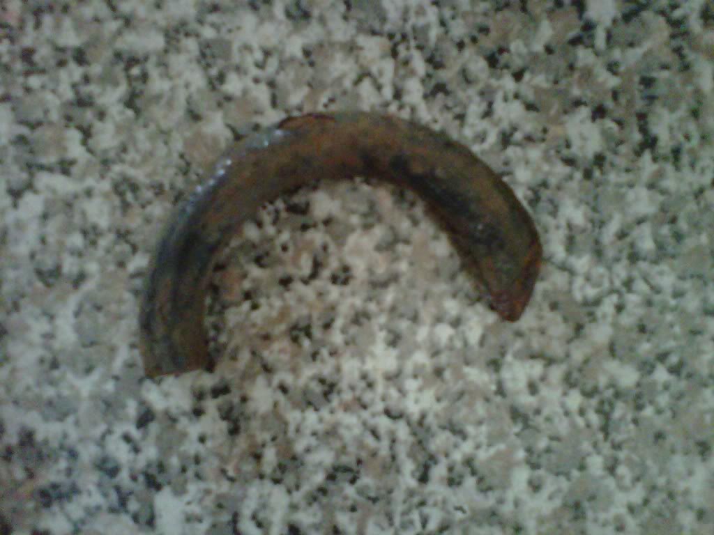

I found the source of the rattle.. While there is a similar rattle when I pound on the fuel tank from under the car, it's not what is making the sound while driving. I pulled this out from the base of the rear shock tower coil "seat" :
Crappy phone pic..
This could explain the uneven tread wear that is only on the tire at this corner of the car. Which would mean that the spring has been broken for quite a while.. Yeah yeah.. Get low, I know...
