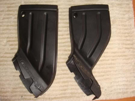

What I am planning on doing to my Intake is buying a K&N High flow, replacing the stock snorkel front piece (the piece that screws into the body by the headlight) with a v6 snorkel because it is wider (Pics below), maybe making a heat shield to keep even more heat out, and finally doing this mod: (sorry for linking another forum)

correct me if im wrong but i dont think the 3.0 air vent will match the holes with out 1.8
Im not 100% sure on that but im thinking the holes were spaced further apart. . . That would be my only problem with that. ohh and also take out all the sound deadening in the airbox. That helps alot with airflow and will get u that small bit of extra sound.

Sorry for the extended break! Got caught up in school and midterms. A couple weekends ago I pulled out my airbox, slapped in the high flow, took the sound dampening material out (did anyone find a way to pull the inner frame out so you don't have to rip the material?), and put in the v6 snorkel. I took pictures and sound clips of before and after the sound dampening was out but I don't have them with me so I will post them when I have them. The snorkel was a pain in the ***! You have to angle just right and then help it into the cut out on the grill. It isn't a perfect fit but the opening difference is huge. The holes do line up once you get it in place as well. It makes my car look special from most 1.8's as well

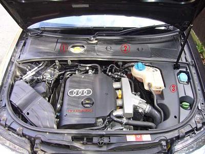

in a sense I am moving my car towards that as well. I don't think I am going to do a BT setup in the future, just a chip soon. I am also looking at that same power-steering cover you are, Does it really need a lot of chopping? I have seen some pictures of 1.8t guys with the cover and it looks like it fits perfect. Like the one attached. People that I see seem to have mixed luck. Some cant get it to fit without some hacking and others say it fits perfectly but I am not sure how the 1.8t guy in the picture got it attached.
