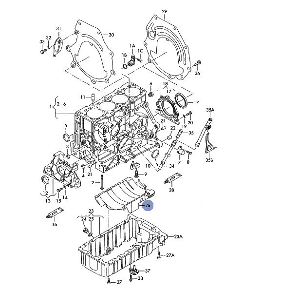

I know this is a stretch, but do you have the windage tray in the oil pan? #26 in the first picture? This could be a reason why corners create this condition. I would think it would have to be a fairly high speed corner to make the oil sway away from the pickup tube if the level was full. The other thing I was looking for in the drawings is a check valve in the head or block, but I didn't see one like some other engines have. I would look at the oil filter mount to block component. Inside this is the oil pressure relief valve. Through the flushing that you've already done it's possible that the check valve #3 in the second picture gets a small piece of debris to stop it from moving in its bore. That machined bore to piston is a very tight clearance and anything that could impede it's movement forward to a relaxed spring pressure point would result in lower oil pressure since that valve isn't in the correct position to maintain proper oil pressure. Interesting issue on the electrical side note you mentioned. Maybe somebody else has had issues with a cluster creating problems.

Thanks for your reply... yes that windage tray is in the pan... Interesting that you sell those. So the part your talking about is #1 in the second drawing? if I removed bolt #6 should i be able to see any debris? can I remove that bolt with full oil? Maybe I will do that on saturday to eliminate that possibility. The turning part is really weird to me as well because its a pretty slow turn. parking lot turn. Im going to be installing the gauge on saturday morning and see what that tells me. What oil pressure numbers should I expect to see? anybody else have more ideas? this weekend I will also replace oil filter just in case my flush stirred up a bunch of stuff. More ideas welcome.

Yes I'm talking about #1 in the second drawing, that as the assembly because the plunger and spring 3 and 4 aren't available seperately. You won't lose much oil at all taking those out for inspection, you may lose a few drops. On the windage tray I may have misled you, I was talking about the sales history on #1 from the second drawing, I don't sell many windage trays.
