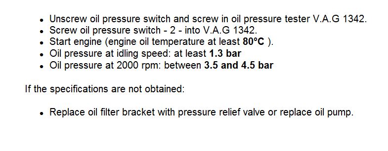

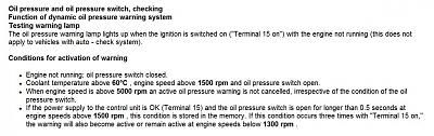

After reading most of this post, I'm going to guess your oil pressure is fine. If after you have made SURE it is fine, even at different RPMs....and there really is no 'sludge' in the system and your oil pickup screen is clean, pump is working fine, and you have put in new oil pressure sensors; and your dealer friend says everything is A OK.....
TRY replacing your coolant temperature sensor and let me know if that fixes it, it's weird, doesn't make any sense, but I've read about it somewhere causing the oil pressure lights to come on on VWs / Audi's at under 2000rpms....Also, I don't think the sensor activates until a certain temp/RPM is reached...(see attached Pictures) Just my .02.....
Have you or the dealer 'scanned' the car for codes? What were they, if any at all?
