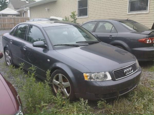

How much would you pay for this 2004 A4 w/ broken timing belt? What mods to do after?
A friend of my father's is selling his 2004 A4 1.8t Auto because the timing belt broke while driving, and I'm wondering how much it's worth.
It will be my first Audi, so I'm not really sure here. It has 110K on it, but had the tranny rebuilt at 90K, maintained perfectly (other than that belt) and was driven by a 60 year old woman.
I can do the engine rebuild myself, and can have the front bumper repainted (rock chips) for like $100 from a friend. While I'm at it, I also plan on: painting/replacing the plastic lowers, tint, rims, engine mods - possibly bigger turbo, chip, injectors, maybe intake etc.

At that mileage with a broken engine, the parts are probably worth more than the whole car together. You should be able to buy it VERY cheaply. I'd get a quote from a reputable shop for what an engine rebuild would go for and then subtract that from the book value for the car and negotiate from there.

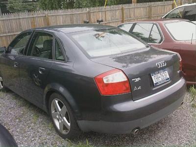

I noticed something else in the pics that made me feel the need to give you an additional piece of advice. Unless it's been debadged, that car is FWD. FWD + AT = CVT. B6 CVT transmissions are known to fail very expensively, and seemingly at random. If you do buy the car, I'd rebuild it and sell it for whatever amount of profit you can make. If you find that you like it and want one, buy one with a manual and/or a quattro trans.
