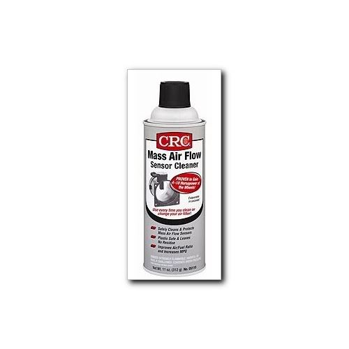

yeah, could be a MAF sensor, most likely it is.
Before buying a new one, there is a MAF cleaner Name:  B000EGH57G.jpg
try cleaning it before buying a new one.
and it is easy.

thanks how do i go about this is there a kit a buy to clean it?

take out your MAF. spray on it with CRC and wait till its dry. plug it back in.

and make sure its totally dry cuz if not if will ruin ur car.
