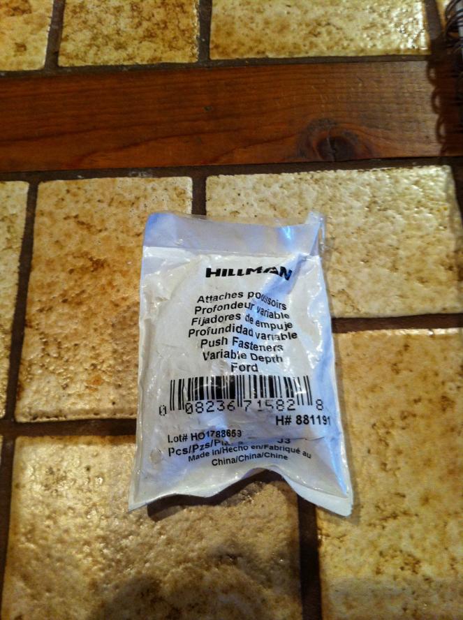

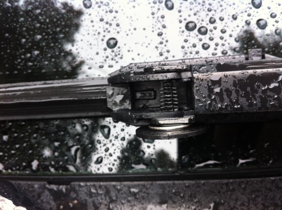

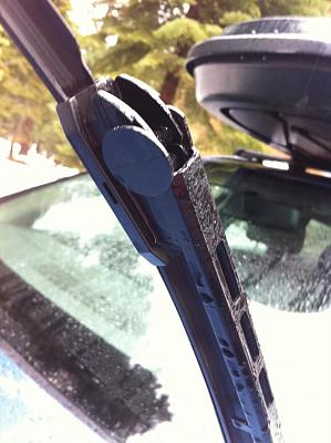

Default Bolts and Nuts or Plastic Push Fasteners...
Originally Posted by Dozanti
Good thread, I ended up using bolts with washers and a lock nut in place of the zip ties. Gives me a piece of mind that my blade isn't going to fly off in a snow/rain storm on the highway. I used the RainX-lattiudes also
As I mentioned in an older post in this thread, I originally used nuts and bolts. However, there wasn't enough free pivot between the wiper blade and the wiper arm, which left a streak through the windshield because the wiper was not flush with the windshield.
Attached to this message are images of those fasteners that I bought at lowes in the hardware section. The drawer said "Automotive". You can also see a finished product.
You can see that I used a small washer to ensure that there was enough free pivot - might not be necessary though.
