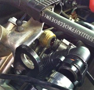

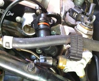

Well my problem was/is that the hose elbow hits the sensor connector and causes it to try to go on at an angle, so i removed the fitting and put it on that way went and bought a larger wrench to re-sintall the fitting, and now discovered that last night trying to force it on, broke the sensor plastic where it enters the brass fitting, not even sure what sensor....long and short of it i guess my idea of easy DIY and you all is very different, so now my car does not run i only have my moto and will have to tow to shop...overall a very bad experience with this simple DIY from BSH.
end results, one broken connector, a broken plastic tab on the pipe release, so not sure how well that will stay in place and when its back to right my guess is it will be 2x what the job would have cost me at the VW dealer to change the stock PCV.

i can see now how the 2pc kit would be much easier to install, but here are two photos to show you the obstruction blocking the install of the hose, and broken connector on some sensor, water temp? no idea what i broke, but i cannot recommend BSH for this mod to anyone who like me is just ok doing DIY's per instructions.
