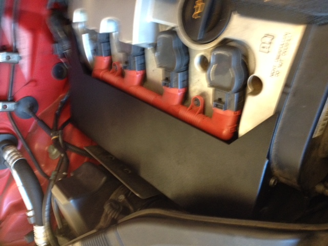

Sorry to wake up this old topic but I thought this might be relevant...
Rev Motoring makes a nice quality custom heat shield that seems to do the job.
Audi B7 Custom Heat Shield A4 2.0T 2005.5 2006 2007 2008 intake upgrade | eBay
Here it is on my car...Name:  Bills%20SHIELD_zpslhocsbp9.png
As you can see, it covers both the turbo and the cat. conv. which are an obvious source of ambient heat in the eng. compartment. I also added a layer of DEI Reflect-a-Gold heat barrier to the inside of the heat shield and the underside of the air intake ducts. So far, it's made a BIG difference in keeping temps down. I can drive for over an hour in Summer temps and my intake ducts/airbox remain much cooler than before.
