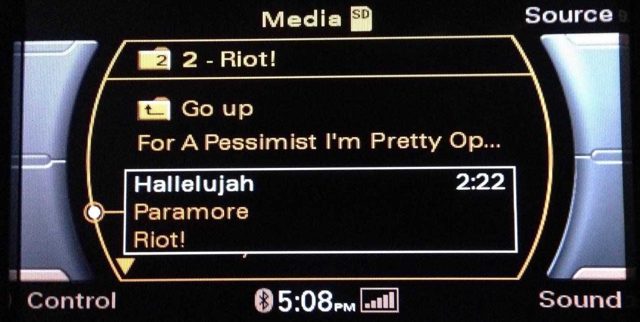

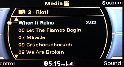

So recently the display changed when I listen to music off an SD card.
Now there is like a popup box that shows the song name, artist name, and album name. I guess I should not say "popup box" because it never goes away. That box was not there before and I can't figure out how to make it go away.
I attached 2 pictures showing the old & new display.
Any help on how to get rid of that box would be greatly appreciated!

My SD card displays like your second picture (921). I thought that was normal -- and I like it this way.
