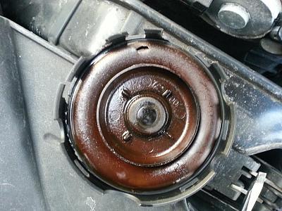

Well although nobody posted back I figured I would update.
Took the cap off the PCV and found this....
I was relieved to see that the diaphragm was damaged. Replaced the diaphragm and cap, cleared the codes out, and so far so good.

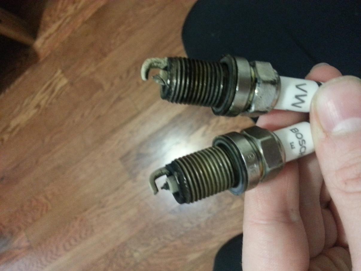

I also replaced the spark plugs and found this..
The plug on the top was from cylinder 2. When I went to pull it, it was really loose, like it was never torqued properly in the first place. As you can see the plug is basically destroyed, and was probably misfiring like a mother.
