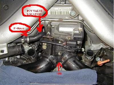

So where is the pcv valve located on the a6 2.7t?!?

Default PCV valve location
PCV valve is Attached to the F hose and one of the ends off the spider breather hose that runs under the left side of the intake manifold. You need to remove the passenger side Diverter Valve to get to it. Remove the F hose from the breather hose and there it is.
