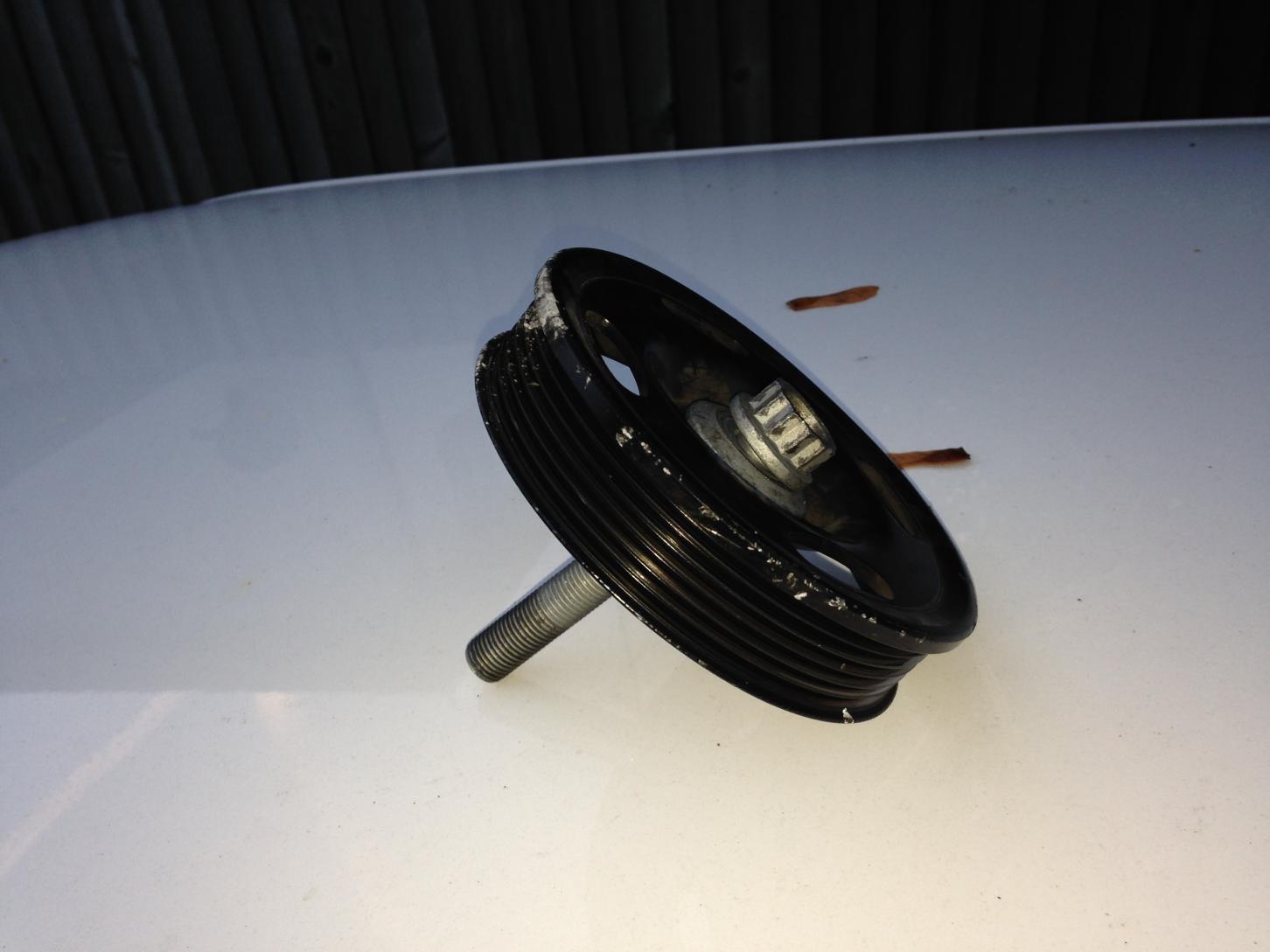

I bought a used approved 2010 A3 from an Audi garage a little over a year. The other day the Crankshaft Central Bolt came lose and fell out whilst driving, resulting in the pulley and Crankshaft Seal being damaged.
My car is with Audi now for repair and I wanted to get a view on why this might have happened, if it’s a common fault and the likelihood I'm going to get a huge bill from Audi. Know its going to be pricy but shoud i be expected to pay given this type of failiure?
Please let me know what you think, I know littlle about cars so would appreciate feedback so I know where I stand in regards to this when dealing with the audi garage.
See picture of damage attatched

That is a very unusual failure. In the dealer's defense, it's not something a tech would even think to check for a cold start rattle.
About the only way this could happen is the bolt was not torqued properly either at the assembly plant or in the field.
