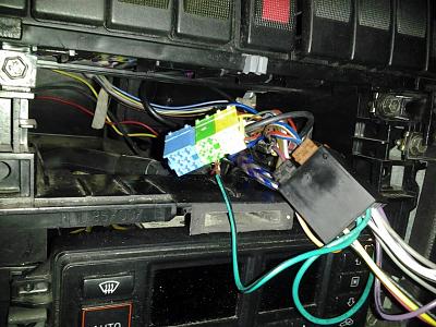

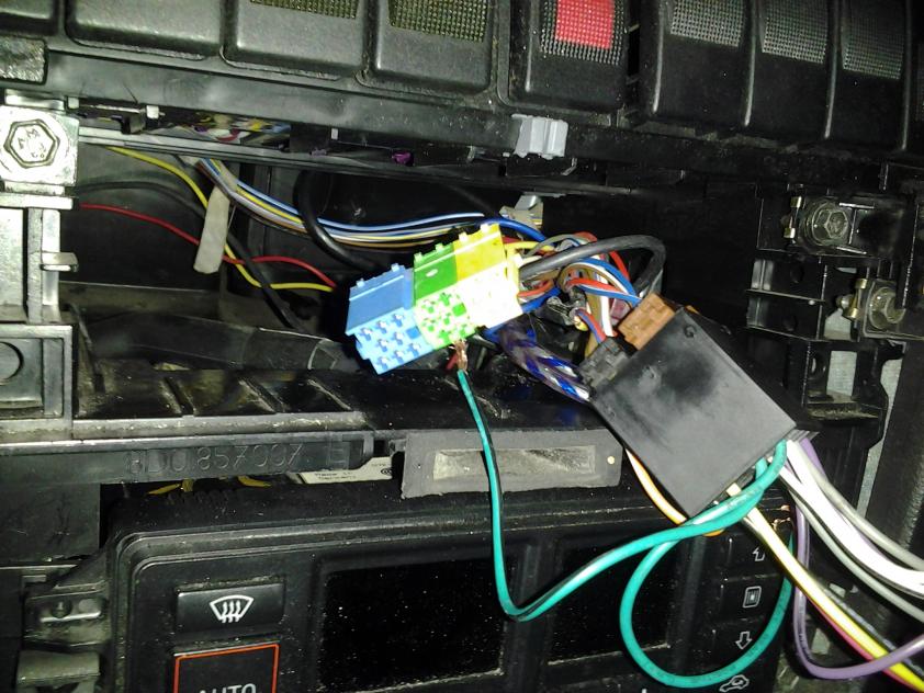

It seems that the amplifier is not powered on. You need to connect the power cable of the amplifier to +12V.
Can you please take a photo to show me the wiring scheme of the head unit?

here is the picture

Do you have photos of the wiring diagram of the original head unit and new unit?

i think i may know what to do i found pictures online that were unclear to me, but after reading that i have to power the amp it kinda makes sense now. i will try it and see how it works out, pray i do not short anything.
