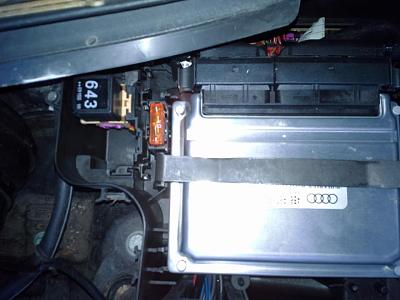

Here is the picture of my ECU box... I have one 40amp fuse which I checked and it's fine...and one relay which I also checked with external power and multimeter, and it's also fine...the resistance does go to zero...So if that is the relay for the SAI pump then the relay seems to be ok...Is there supposed to be more relays in the box? Am I missing any??? Is there a different relay for the SAI pump? suggestions appreciated. Thanks...

I had a torn out vacuum line from the driver side combi valve that goes to the stainless pipe and then to the t-connector. I replaced those pipes. Put everything back. and started the car. The pump kicked in (I think it only kicks on when the car is cold)
By the way, pump was good, relay was good, fuse was good...Luckily I saw the torn out pipe....
