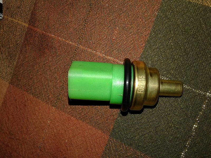

also the sensor with the green plug is what? where does it go?

The sensor is a water temp sensor. It is held into place with a plastic clip that usually breaks when you try to remove it. Get another clip before attempting to replace it.
