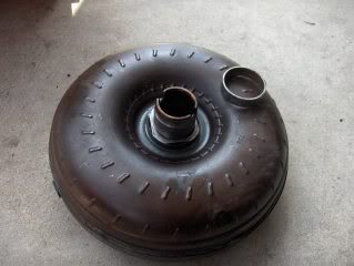

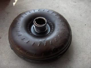

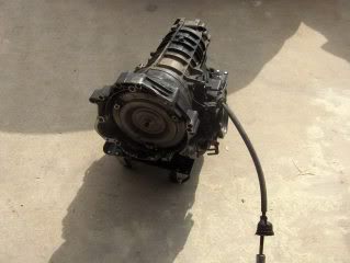

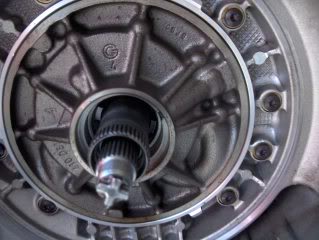

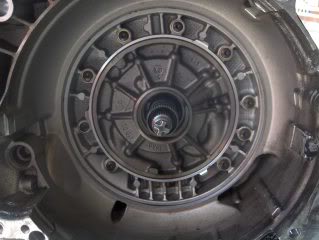

I purchased a 2001 A4 1.8T with automatic w/tip-tronic transmission and 90,000 miles. I bought it for $1000 under the impression that it needed a new/rebuilt trans. After investigating more once I got it home, it only had a huge transmission fluid leak. Once I filled it full of fluid (which isnt easy to do), the transmission work flawlessly. So I have removed the trans. to replace the torque conveter seal. Once I had it removed, I found that the torque converter was difficult to remove, but I did get it out of the trans. Upon inspection I found that there was some sort of a bearing that was stuck to the torque converter. I was able to pry it off and there is not much damage to the torque converter, I will have to do a little sanding with some emery paper. Check out my pictures. What I dont understand is what happened? Did this bearing fail causing damage to the seal? If so, how did the bearing fail? Any techs with experience let me know, Thanks.

Thats interesting, haven't seen that before. I believe its a bearing for the pump and the torque conveter seal sits on it to seal the fluid, but i have never changed it out before. It should be easy to order at the dealer. When at the parts department will give you a picture on ETKA and you just have to point out the bearing, just grab a new torque converter seal and you should be good to go.

UPDATE: I have done a lot of research and I believe I found what caused the problem. At one point the transmission must have been low on fluid, therefore caused the torque converter bushing (the piece that had been stuck to the torque converter) to wear and spin in the pump. That caused the torque converter seal to begin to leak, and caused a much bigger leak in result. So what do I have to do to repair it now?? I will tell you. I will need to purchase an oversized pump bushing, have the pump machined to fit and purchase a new torque converter seal and I should be good to go. If anyone can correct me on anything, please go ahead. I spent many hours researching and locating parts. I will keep this thread updated.

I've been there done that. By the time you've removed the front pump you already have the valve body and differential completely off. Why? The 6 tubes for the valve body to pump. At this point you'll need a new torque converter and new front pump. But being ran low on fluid the clutches/bands are worn to a point that you should replace them while you're there. You should be able to get a complete overhaul for ~1000 seeing as the tranny's already removed. Throwing a front pump will not fix your problem for long (if at all) and the torque converter should not be sanded as the damage is done and it'll leak. Transmissions are on car-parts.com for about 1grand also, but I'd prefer a rebuilt.

or try http://www.omegamachine.com/ they have the bushing for $20 but the bushing have to be remachined after installing it in the pump.

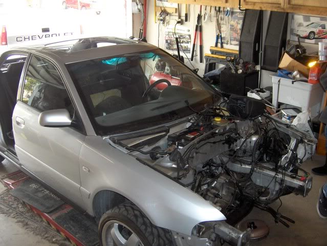

Thanks for the help and tips. I am actually in the process of installing a used transmission. I purchased a local parts car that still had the transmission all for $650. I found the car on Craigslist. I was afraid that I would have the same problem that you described, leak problems after reinstalling, so I searched and searched and found this parts car. I ultimately got a great deal. The car had just under 105,000 miless on it. It was already well parted out, but I have almost made all my money back on other parts I sold from the car, and I still have a lot of parts left. So, I found a great deal, and my transmission is going to be free once I sell a few more parts I appreciate your help flyboy007. Check out the picture I have when I bought the parts car, and a picture once i was done stripping the car. Thanks again for your help.
