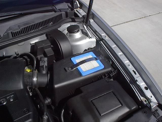

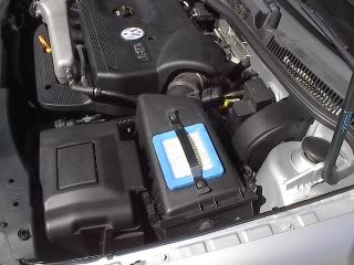

............Might this work on your car? Name:  IM001093.jpg

it could, but since my intake setup is identicle to this one...
it honestly would have about the same effect since there is a tube from the front of the grill connected to the airbox.
as for your idea...its a great idea if you have/already done so, incorperate a scoop to supply that new opening with freash air from either the side or top of the car. I have an SRT-4 (my other toy) and the hood scoop is fucntional and has a tunnel to the airbox, along with the main purpose to help cool the turbo. that mod works very well on supplying "Cold" air from the front of the car(once you insulate the hood from engine heat)
you could easily insall a direct opening on the hood or a sidevent on the fender and plumb a tunnel to that filter giving you the same effect and providing a "little colder" air
also since the MAF in that picture is the round type...it would be just as easy to add piping to the lower fender area for that same effect. since mine is the type that bolts to the airbox...I am limited.
I guess a more prudent question would be...can I put the MAF from a 1.8t in place of mine since I have a 2.8? (since essentually they are doing the same job)
~Goldie

.........There's a factory tube that runs from the airbox between the fender and the battery to behind the headlite on the GTI for outside air. Its a crowded house under there to enlarge a fresh air system with hardware store duct work to the stock air box. This top of airbox filter mod draws under hood air. The stainless strap across the filter is there not to retain the filter but to hold the under hood insulation up off the airbox with an open filler element now. A little more intake roar was the goal. Hot under hood air? Yes. Power increase? Unlikely. Most of your aftermarket CAI units have filters under the hood in the hot environment too!................As far as a change in your MAF. Your 2.8 computor may be looking at different parameters not provided with a 1.8 MAF swap and cause your car to run lousy. An expensive experiment with the price of a new MAF with little to be gained even if it runs well and you engineer the ductwork well. Better to spend your mod $$$ elsewhere.
