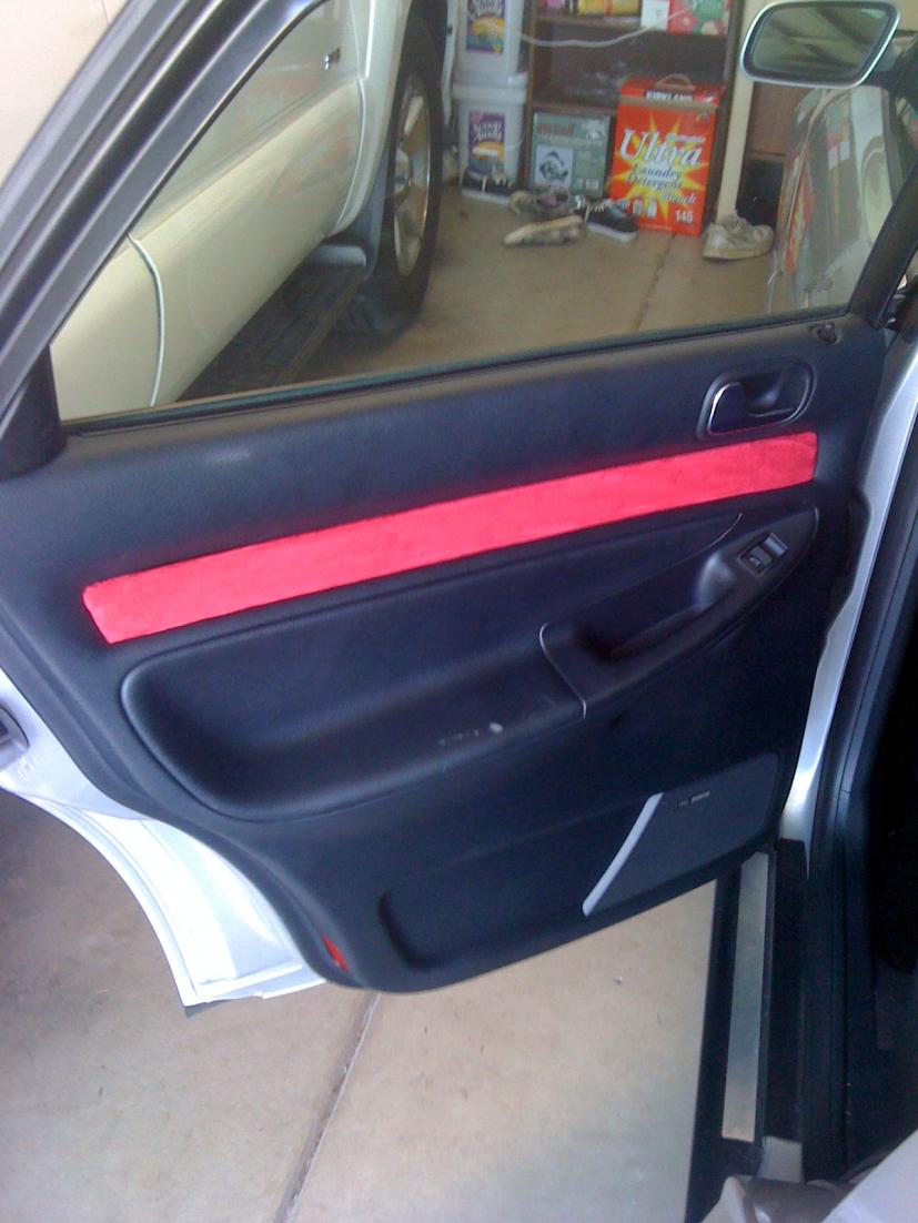

It the thing under the red suede. the part were you rest your arm.

Pull the door panel and grind off the glued tabs. To reinstall, use plastic weld.
