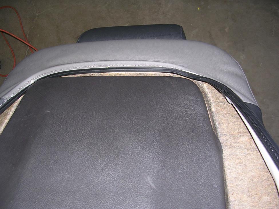

How do you remove the driver’s seat backrest rear panel on a 2005 Audi Allroad C5. I need to access the backrest motor. Pictures would be helpful.

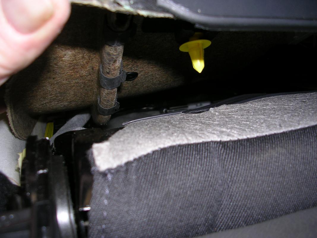

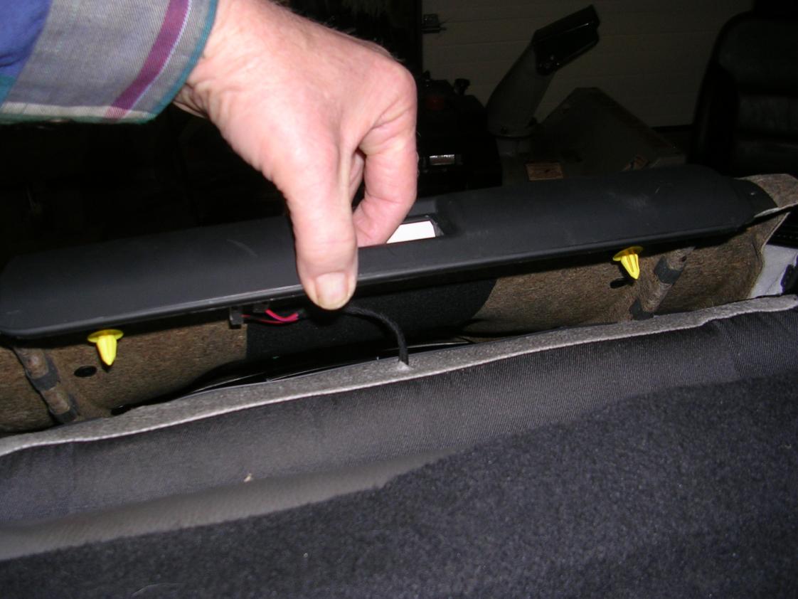

Bentley gives you the basic idea on how to remove the back panel but leaves out 1 important item. The upholstery around the 3 sides of the panel have to be peeled out of the groove in the panel. There are 2 clips that have to be removed, these are under the bottom of the panel. They are plastic and depending on age may break but can be found at most auto upholstery shops. Once you have the clips loose then lift out and down with the panel. See some photos I have attached.
Hope this helps someone else.
