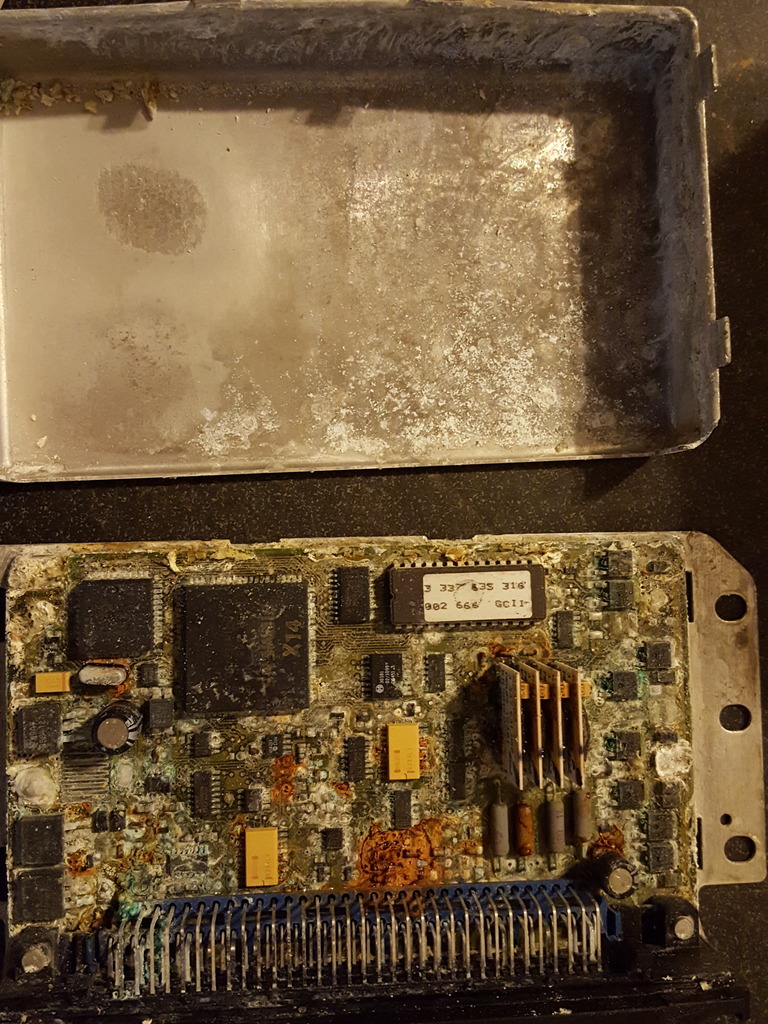

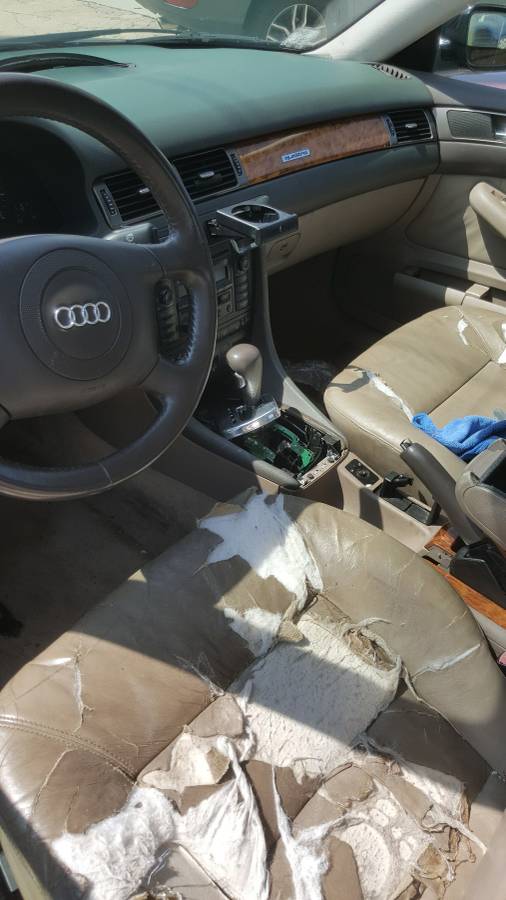

I have ran into several issues already lol, now I know why it was $350 but I really did expect some issues. The TCM was soaked and fried, gear shifter destroyed and seats tore up. I like a challenge

Your TCM is probably soaked because the plenum drain is clogged. There is usually a rubber drain plug on the passenger side of the plenum(sits low, near the firewall). Remove it and throw it away. Also, make sure there are no leaves or other debris at the bottom of the plenum.
And I'd be willing to bet the connectors and wiring to the TCM is pretty scary looking as well. It's a lot of work but all of those connector housings and wiring pins are still available.

You are correct, it was clogged. I purchased both the TCM and wire harness off eBay for quite cheap. (TCM $35, harness $32.99 .. both free shipping) I'll just have to mate up the wires, solder them and shrink tube them.Originally Posted by UberTeile
