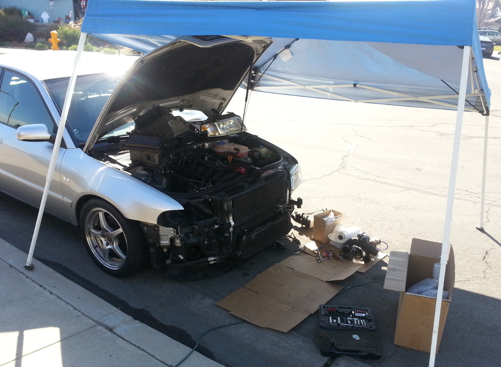

Here's how the car looked on Monday:

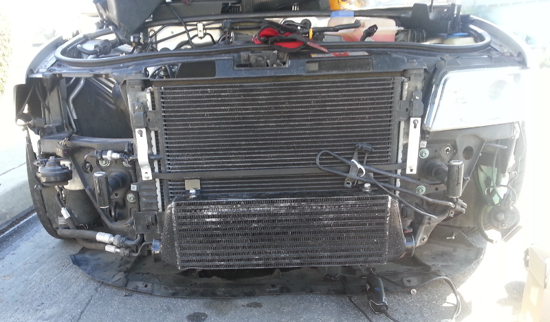

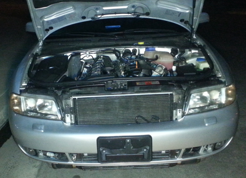

Yesterday I spent a number of hours fitting the intercooler piping. Yikes, that was rough. I mean, it fits decently, but getting everything to line up in a suitable manner just took a while.
Wiping WD-40 on the inside of the silicone couplers allowed the pipes to move more freely, which made fitting everything easier, and WD-40 will evaporate. I would recommend this.
Today I made my way over to Harbor Freight with a 25% off coupon and bought their 3" cutoff tool. I knew there was no way my Dremel would cut into the bumper rebar.
It took a lot to cut the bumper to make it fit... more than I was anticipating. But it's on, thought could probably still use more trimming.
And I still need to start trimming the lower valence, but at least I have crash protection now (gotta go back to work tomorrow... 12 days off work FTW).
Here's how I finished tonight:
