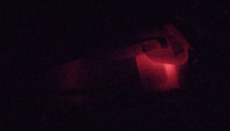

Well, last night I replaced the turbo-to-manifold gasket with another $15 Cometic gasket hoping it would solve the rattling issue I've been having that seems to be coming from the front right of the car. After installing it I drive the car hard (once it's up to operating temp) and get the turbo hot enough to do this:
Then I torqued down the turbo mounting bolts (while it was very hot) and clamped the locking tab around the bolt heads.
Unfortunately the rattling persisted, perhaps it was even worse after replacing the gasket/torquing bolts compared to how it was prior! I continued to tighten the turbo mounting bolts after several heat cycles but the rattling still occurs when the engine/turbo are hot enough :/ I'm gonna contact FT about this again.

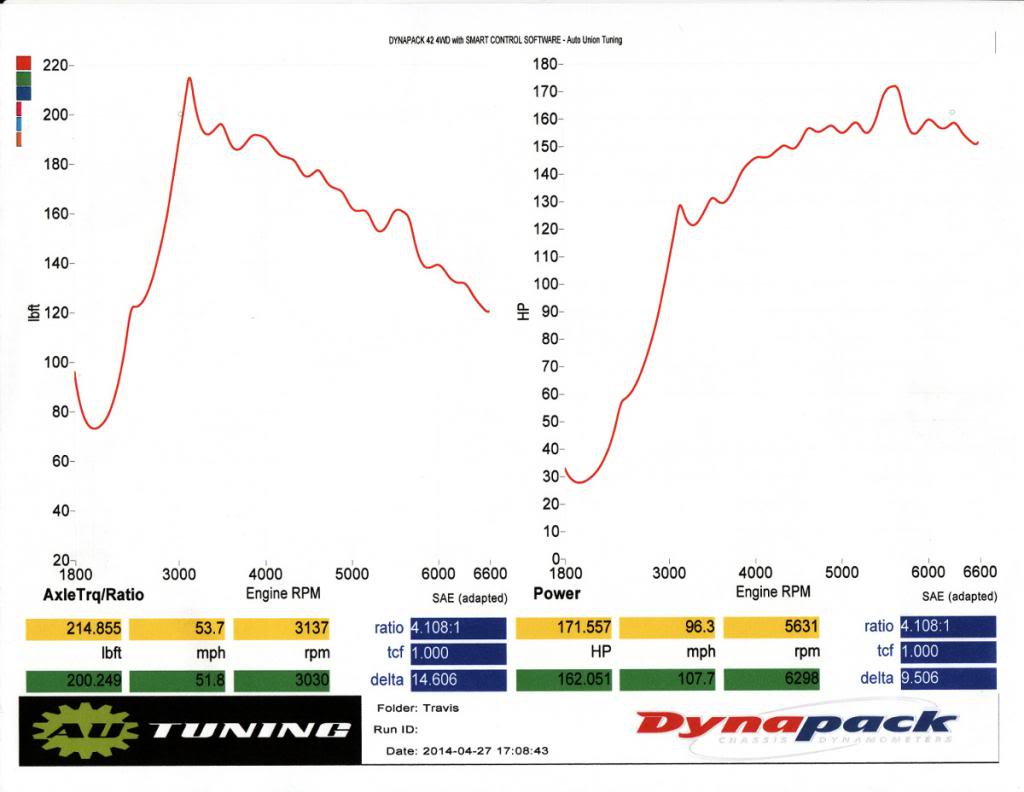

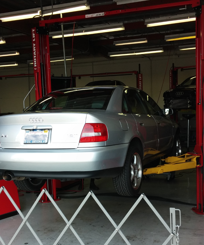

Today I did this:
And this was the outcome:
Was kinda disappointing to say the least. The dyno tech said they recently had a B6 A4 with FrankenTurbo F21 kit and same 550cc injectors, also straight 91 octane, etc. that put down 245 AWHP !! My relatively small 170 AWHP doesn't even compare to that... also gonna ask Doug @ FrankenTurbo his thoughts on this.
