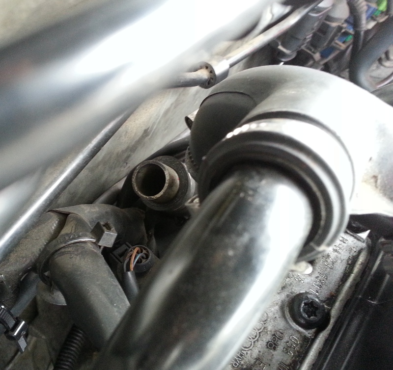

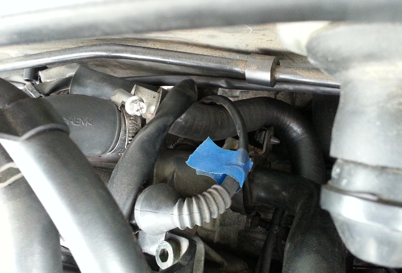

Haven't gotten a whole lot done on the new car lately, mainly just little things here-and-there like boost leak testing/fixing (intercooler pipes).
I haven't gotten a new tune from Motoza because my setup has been flawed... basically due to air leaks causing my fuel trims to be out of whack and giving me a lean code (which turned on the CEL).
So yesterday I set out to do some diagnosing to find vacuum leaks, since a boost leak test can't test anything past the check valves (all check valves and PCV valve are pretty new, so they don't let boost past them).
Within a minute I found this:
It's part of the 034 breather kit. Basically the short metal pipe at the end of the silicone hose came out of the valve cover breather hose (at the back of the engine). Must have gotten oil residue on it and slipped out, or something (hose clamp was still tight).
Such a simple thing, easy fix. Cleared engine faults, and so far the CEL hasn't come back yet. BUT my fuel trim is still majorly negative This means I still can't resume recording data to get my Motoza tune updated.
