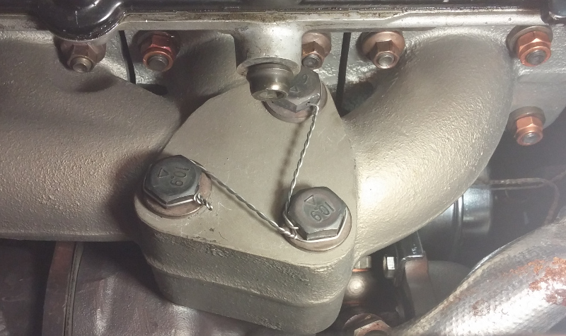

Yesterday after work I made 3 attempts at safety wiring the turbo bolts. I had never safety-wired before, but I figured it couldn't that difficult.
First attempt:
Bit loose around the bolts, definitely wouldn't keep them tight enough.
2nd attempt was a little better, but still not tight enough. It's a challenging area to work in, no doubt. Also the safety wire pliers I bought don't twist counter-clockwise so any counter-clockwise twisting had to be done by hand.
3rd (and final) attempt:
Not too bad, came out pretty tight. Seems tight enough that there won't be any bolts backing out. I know how it can be improved but I had a dinner thing to go to and considered this "good enough".
Here's to a long time with NO MORE FrankenTurbo issues!!

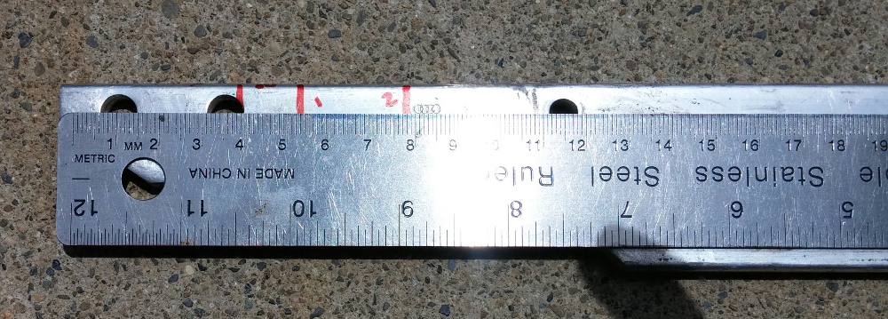

Haven't really worked on my car in the last month. However, about a month ago finally installed the A6 OEM strut tower brace. I had the A6 STB brackets on the car for probably a month prior, just needed time to fit the A6 aluminum bar.
Turns out the A6 aluminum bar fit pretty well. It took cutting one end down by about 43mm and also re-drilling the two mounting bolt holes (25mm apart from each other).
(left-most red line is where to cut the bar, lines 1 & 2 are where the new holes are drilled)
Since installing the STB I've noticed my car creaks a lot! (or maybe it did before and I just hadn't noticed/don't remember). The car is pretty tight though... front STB, AWE DTS, 034 rear sway bar, Eibach coilovers, 034 street density engine mounts, Apikol rear diff mount...
