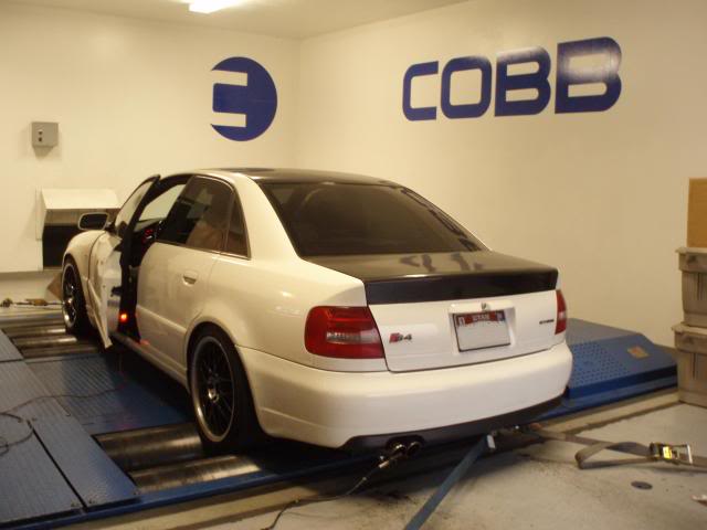

Originally Posted by skatemerica155
I have dyno'd it at a local subaru shop called cobb and it made about 415 hp, but im in utah far above sea level. If you want a reliable fast S4 go with K04's. And AWE might now be the most powerful kit out there but it sure is reliable.
I do have a cam with a custom file from a local audi shop. but other than that i have tt downpipes with a custom exhaust, awe intercoolers, samco hose kit, RS4 clutch and pressure plate, lightweight flywheel, but honestly i bought the tubular manifold used and it did help, and to be fair it wasnt a mustang dyno which i know are a tougher dyno. I just think all the hassle and work of gt turbo's just arent worth it when you can get a very good amount out of K04's.
I'm not on here too often, so I didn't see this, but I have a VERY hard time believing that an OTS AWE stage 3 kit, even with cams, did 415 to the wheels on Cobb's dyno. Some factors being that it is indeed a Mustang dyno, and one of the lowest reading around. It's got the reputation of a being a heartbreaker dyno, and we're at 4300ft above sea lever with 91 oct. When I dynoed my stage 2+ car there I peaked 225 whp and 271 wtq, and another stage 2 that dynoed since did 217whp (for reference other stage 2+ dyno's are usually around 280whp.)
OTS AWE stage 3 kits are usually in the vicinity of 360-380whp on other dynos. I can't say it didn't happen, I just have a very hard time seeing it as feasible.
