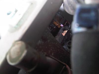

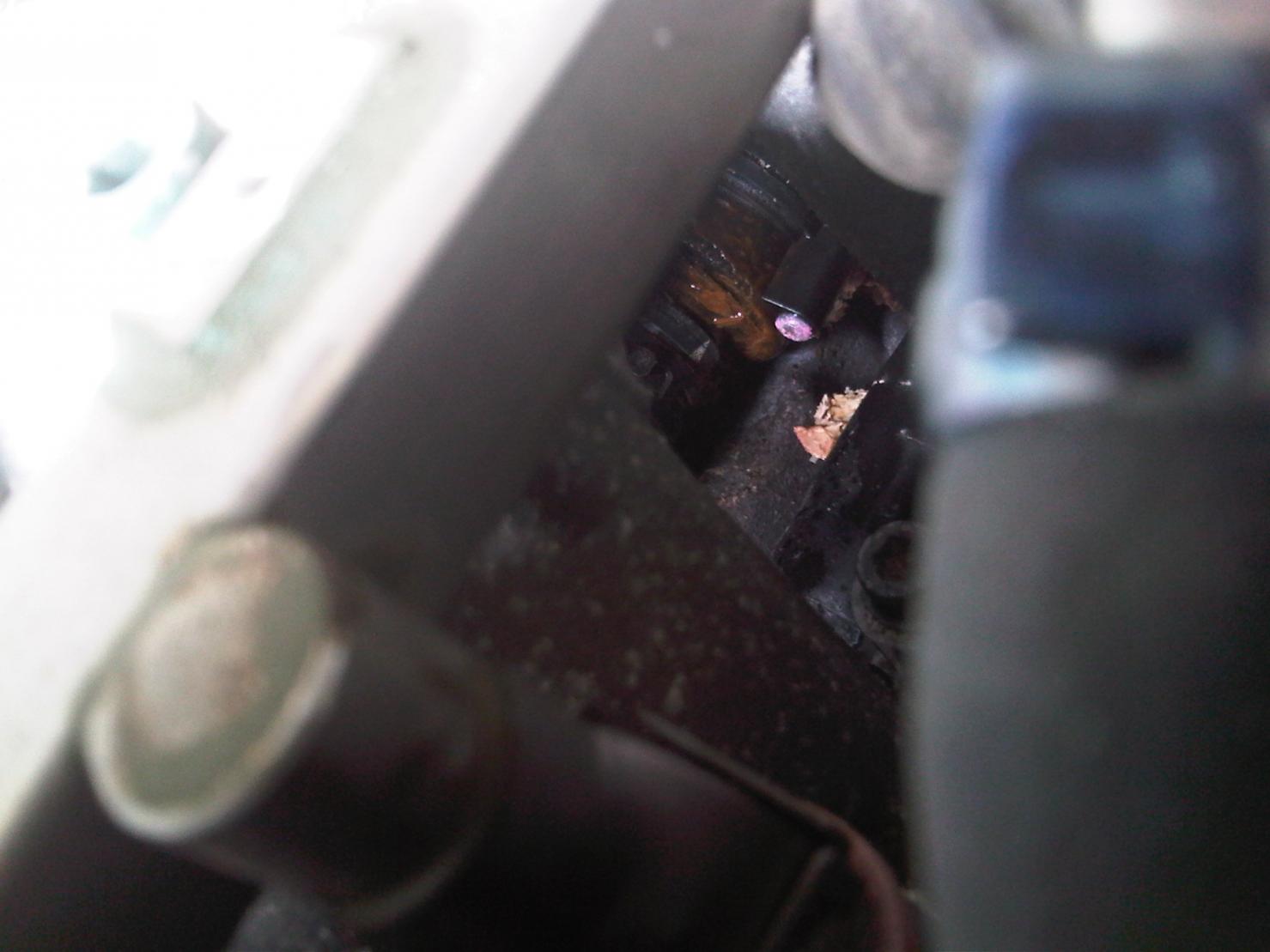

Ok, I found the leak it is directly underneath the intake manifold in the center of the engine...where is the aux water pump? Is that what this is? Or is this just some sort of plastic flange...any way of getting around taking the intake manifold off? I will try and post a picture of it.

here is the picture of the piece that is leaking...under intake manifold

yes that is where the aux water pump is. you have to take off the intake manifold and throttle body to get to the aux water pump. i bought the replacement pump and gaskets at ecs.
Old Jul 25, 2010 | 10:50 PM
aspen79's Avatar
Joined: Aug 2008
Posts: 420
While you are in there, check to be sure it isn't the coolant pipe o-rings leaking, they can seem like the aux pump. There are 2 of them under the intake and have o-rings at the front where they go into the block, as well as another on the left side pipe at the joint to the coolant manifold on the rear of the heads. To fix this you need 5 o-rings total (3 of one kind and 1 each of the other sizes). These are a semi-common leak point, and will leak a lot of coolant, sometimes suddenly while driving the car (have seen it just run out on the ground as you pour coolant in the reservoir). Unfortunatley, the o-rings are a pain in the you know what to repace. Just something to keep in mind while you're in there.
