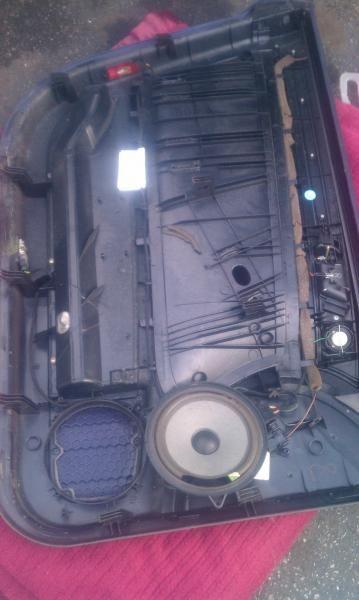

Door panel removed. There are other write ups on removing the door panel. It is not difficult. Do the passenger side first. Keep the window up. If it rains or you need drive you can shut the door and go. To lock car manipulate door lock cable with door shut. Remove screws on rear end and front end of panel. Release window switch and plug. Gently lift door panel. Release lock cable and other plugs. Look them closely for release method, no need to force. Clips can be on side or depress center clip. Do not break clips.
