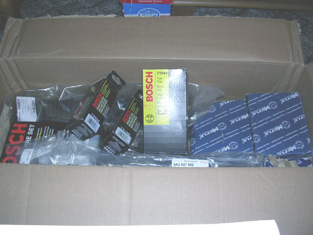

I finally got around ordering the crank bolt along with some other stuff
- exhaust studs + nuts (replacing all of'em - on the heads and the exhaust - 18 total)
- the caliper retracting tool ($ 9.95 at ECSTuning)
- some silicone hoses - got some different color segments to still identify/troubleshoot them easier in the future.
- new oil drain plug (the magnetic one)
- 2 GKN outer CV boot kits (to freshen up the old joints when I'll replace'm - both will make for good spares rather than throwing them)
- 1 gal of VW blue antifreeze
- some other minute stuff
Now I need to get going with the reassembly of the camshaft and get the heads back on.
I dredge trying to get those old exhaust studs out, but I gotta do it. They are so rusted and half of'em came completely out...
Will report back again in a few days.

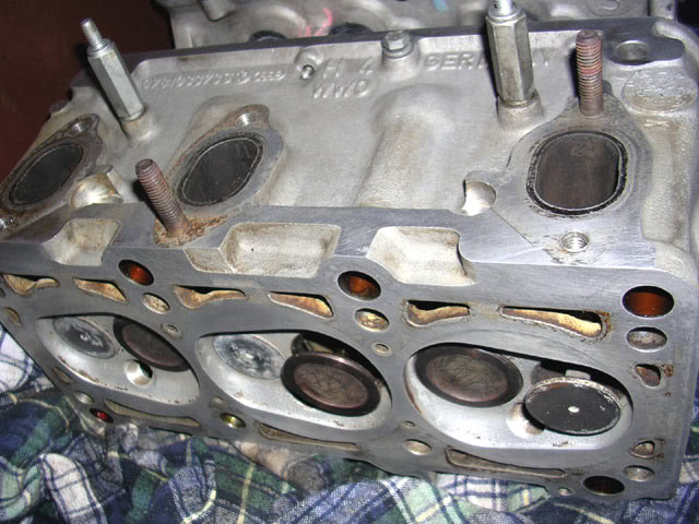

I finally got today some work done.
- Changed the trunk struts ($ 17/piece from AAz - Meistersatz brand); the trunk lid doesn't drop anymore, it also lifts as it should; took me a while to decompress the new ones about half of an inch to get'em in, but it was all worth it.
- Replaced two injector terminals that got broken ($ 7/piece)
- Replaced two coolant hoses; the section at the bottom of expansion tank, and the next section connected to the pipe running toward the T-stat housing.
- Unplugged the heater hoses and flushed the heater core. It still was some leftover crappy coolant on the lines.
- Got the camshaft back on bank 1 and turned it back to where it was at "TDC" - Cylinder 1 intake and Cylinder 2 exhaust valves open.
Also replaced the camshaft seals on both banks and the cam plug on bank 1
Next in line is to put the heads back on, but I'll have to wait for the exhaust studs; also to finish replacing the vacuum hoses with the new silicone ones.
Assembly Grease on all the "moving" parts
Both heads are ready to go
Valves on cyl 1 and 2 are open again
Jim,
sorry for the "nagging".
How do you suppose to install those "shoulder" studs?
Do I have to tighten the nut in the "upper" (exposed) portion, put some threadlock on the bottom portion that goes into the head, and then thread it in using the already tighten nut?

Usually you use a 'jam nut' - two nuts tightened against each other -for studs.
However, I wouldn't tighten the exhaust studs too tight. Usually using loc-tite finger tight (shoulder seated) plus 1/2 turn is good. Let the Lock-tite cure, then install the manifolds.

Installing Exhaust Manifold or Header Studs
By John Aho
Studs are designed to be fitted only "finger-tight" into their threaded hole in a casting. However, a locking type of nut (PTN, or prevailing torque nut) is often specified to go on the stud. These two facts present an inherent dilemma. The grip of the PTN on the stud can easily turn the stud when you don't want it to (how often have you removed an exhaust manifold nut and had the stud come out at the same time?)
With this in mind, the installer may be tempted to over tighten the stud into the hole, to make certain it stays put. This mistake happens a couple of ways: Either the stud gets torqued after it bottoms in the hole, or the stud's shoulder (unthreaded section in between the threaded ends) jams into the surface at the edge of the hole. Some studs have no shoulder (all thread), and some holes have no bottom (through hole). This allows for another problem: with nothing to stop it, the stud can insert too deep.
So, why is it wrong to tighten the stud into the hole? Unfortunately, I have even seen it done by supposed "professionals". The way a stud can outperform a bolt in clamping efficiency has to do with the even distribution of stress across the engaged threads. If you torque a stud into a blind hole, you lose that benefit, and concentrate stresses at the first thread in the hole. If you torque the shoulder of a stud against the edge of a threaded hole, you lose the benefit & usually distort the mating surface. It's not as if there is a suitable bearing surface to take the load. Just don't do it.
By John Aho
