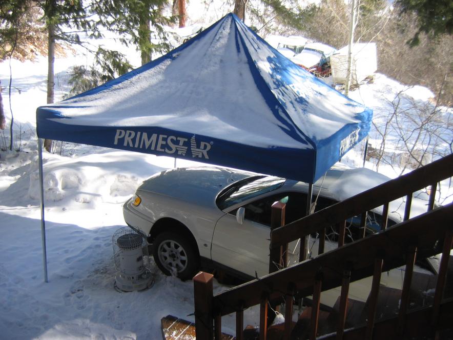

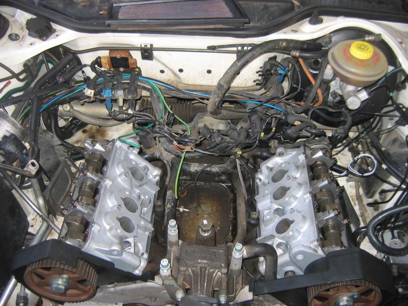

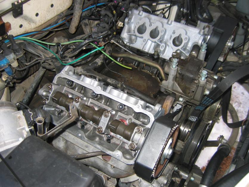

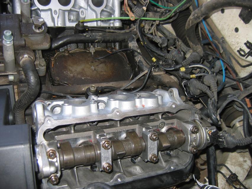

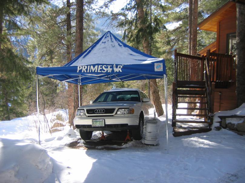

Here's a few pics of my R&R of the A6 @8,000' elevation! Great fun! I'm ready to install the intake manifold and am wondering about the tightening and torque sequence. Any advice would be appreciated. . .

I bet you had lots of fun torquing the head bolts, eh?
Boy, aren't those heads looking gorgeous? I feel ashamed now that I didn't clean and milled mine... (By the way, if you're in no hurry, you can remove and clean that valley pan cover ) Did you get new camshafts too, or they look "untouched" from the cleaning process?
Anyway, for the manifold there's no special sequence posted in Bentley. I just went with a cross pattern. The torque if I remember right off the top of my head is 15 ft lbs, but I need to double check and the freaking EBahn software doesn't want to open right now (some ntdl.dll error)...
I'll get back to you on the torque.

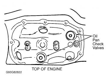

head bolts are 44ftlb, then 90 degrees, then another 90 degrees. You MUST use new ones as they are 'torque to yield' bolt and can only be used once due to stretch.
Here's a tip, let 10 mins pass between the first and second 90 degrees to let the bolt 'set' and get a true torque.
Second tip is.. see that lid in the valley? pull that and remove/clean/replace the check valves in there.. they help keep oil in the head during startup and idling.

Man That Audi sure left you out in the COLD! Sorry to see that hope that heater keeps you warm.
