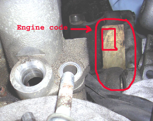

you should be able to look it up behind and under the power steering pump. It is etched on the the engine block lip....which you may need to wipe it clean to see the code.
Attached Thumbnails ATQ or AHA Engine '99 Avant 2.8-eng-code1.jpg   ATQ or AHA Engine '99 Avant 2.8-eng-code2.jpg

Thanks for the reply Guys.
I did have a look there Chefro, but i couldn't see clearly, so i just gave my local Audi dealer my VIN and he said it's an AHA.
Appreciate your help.
