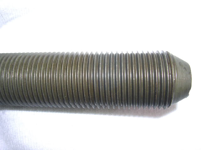

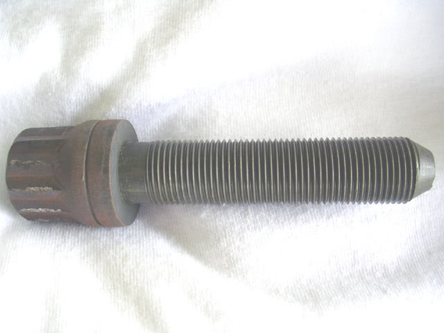

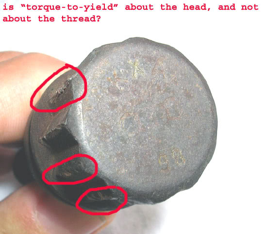

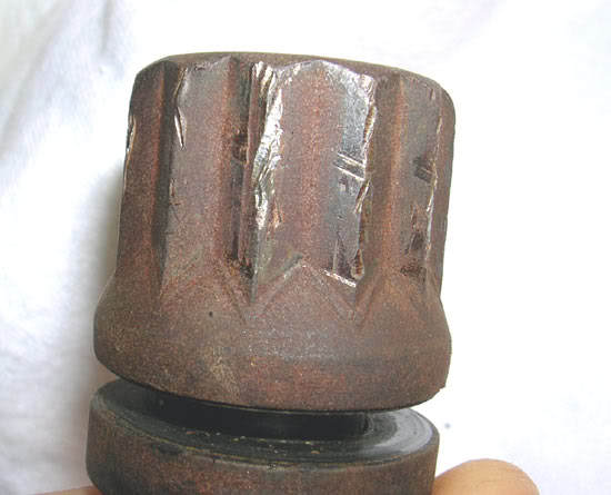

I would love to know why it is necessary to replace it always if there's no galling on the thread.
I tried to read about "torque bolts" vs "torque-to-yield bolts", but plastic state vs elastic state may be too much to get into from my "mechanical" perspective or easy/practical understanding.
Is the TTY about the head of the bolt, or about the thread? Or is it a relationship of the both?
What is the risk to put the old bolt back in with threadlock on it?
Tks in advance, guys.

Reusing a "torque to yield fastener" may result in catstophic failure! Do you want to risk having a bolt snap off in your crankshaft?

They are put in tight and stretch when removed so you would be able to notice any fractures by eye. Same with head bolts the damage is done removing them. I would need a case of Xanex if that broke off in my crankshaft. If you reuse them most likely you would snap it off next time you go to take it out. The CV Joint bolts are as well. 21.27 from Audi and I'm looking at it right now. Some how I don't think the shipping will be worse than the 200% mark-up.

Yep.. it would most likely snap.. but not when you removed it again. It would do it during that 'plus 1/2 turn'.. then you'd be really pissed.
You dont really need to get the Audi bolt, you could get any metric grade 9.8 or higher bolt of the same size and pitch - M18 (size) X1.5 (pitch) X85 (length). Head down to the auto store and ask them to look up any metric grade 9.8 or higher of that size. If its not a T2Y, then go to about 170-175 ft-lbs.
