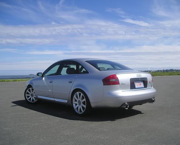

It is actually quite simple. Just have straight aftermarket tips welded onto the stock mufflers and have the rear valence cut to expose the tips. The 2001 and earlier bumper is actually one piece, so you cannot just replace the black valence.
I did this for my 2001 2.7T, magnaflow 4" angle cut tips that I got from www.fle-com (Full Line Exhaust)...
The cutouts are lined with common chrome door edge trim available at any auto parts store.

-thank you very much bostondriver. (i am also from the boston area).
-how much did this run you? ($)
-very beautiful car (looks like the renn sport 6 model)

Yeah i hate the way audi hid the tips on the A6 that way, boston driver's modification is simple and looks great, but make sure you get an exhaust like his that fills the entire cut out so it doesn't look like it has been cut. Another thing you might wanna try to do is buy the exhaust you want first then measure the diameter of the tips and have the exhaust shop cut it and align it for you.

Hey Boston - your car looks GREAT!!
I'd like to do the same to my '01.
A couple of questions for you:
- Do those tips weld directly to the stock exhaust?
- Who did your work for you?
